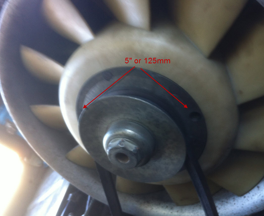

No tools, including this fan holding tool, came with mine is why I was asking.
Sometimes in situations like this, if it is handy, the sharp impact of an impact wrench obviates the need for a holding tool. Not the torque per se but why an impact can remove the lug nuts from a wheel that can rotate freely when the regular wrench can't.
Wondering if this is like that, and the nut dimension.

thanks Jim but was referring to the one on the fan/fan belt in lieu of having no fan holding tool or pinz toolkit if an impact could loosen the nut without necessitating holding the fan.
and the size of the fan bolt.

Sadly the pin spanner at HF in no way is large enough to fit in both the holes on the fan that are on opposite sides. I measure about 5" between holes or 125mm.
Maybe there is a different tool at HF, but this one is not it. Max spread on this tool is about 2 inches.
Anyone with an alternate method or local tool to hold the fan for re-installation of the fan nut please clue me in.
An air gun gently removes the fan nut instantly without the need for a holding tool. :wink: But it needs to be a short socket with a small gun and a swivel on the hose to get it in there.
But for some reason there were 6 spacing washers in their instead of the 4 the manual indicates. No wonder the belt was a tad loose.

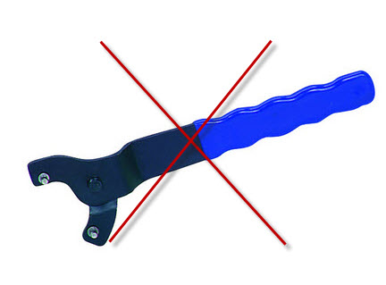

Pulley Wrench, A - Pulley Wrench (Spanner) For Porsche 911

19D20 wrote:Pulley Wrench, A - Pulley Wrench (Spanner) For Porsche 911
Pin is in the wrong spot (inside radius?) on this as the are located on the front of the fan. Needs to be more like this I think.
That tool looks like a motorcycle shock adjustment tool...at least for my Ural anyway....
