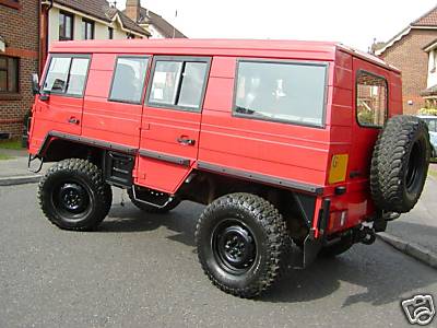

I do not know what kind of use you intend to do of your beast but, if you intend to carry passengers in the back, I would strongly recommend you to open an additional window between side doors, if you go for 3 seats on second row, and another one on rear side if you go for more jump seats on the back. I do not know if you had the opportunity to travel in the rear seats of any K Pinzgauer as it is a quite claustrophobic situation. In Australia you have wonderful landscapes and I'm sure your passenders would appreciate such upgrade.
I enclose a picture of a 716, allegedly a factory demo vehicle with such a feature. I'm doing something similar on my 716 k with 9 seats.
716 k.jpg (24.59 KiB) Viewed 11390 times

G'Day Gunipinzmutt ....sorry for my late reply!
Thanks for your post and the suggestion to add extra windows to relieve any claustrophobic feeling in the rear by passengers, but in actual fact I'm not really intending on carrying many people in the back, rather it will be seating for a camping setup which I will finish once the vehicle is registered (I'm only having two seats with a walkway between them)......The rear lift up sides are also part of my "setup" :D
BTW, the overall aim of the finished design is that externally my 718 will look totally factory "original".
