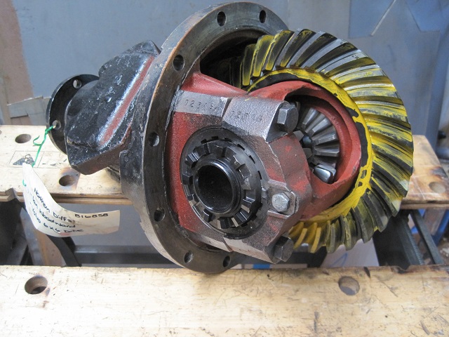

I had all the diffs (3 of them) rebult with new CW&P sets in a higher ratio to help improve RPM/Kph - the diff ratio changes from 3.44 to 2.91, the overall axle ratio from 7.09 to 5.99 considering the portal box reduction. CW&P were custom made in the UK by a Volvo enthusiast to the same ratio as the 4x4 but including the added spline the 6x6 requires for the rear axle pto drive.
This new ratio should help when the diesel conversion is done.
Rear axles installed, and I even had help (briefly). Will eventually repaint all the axles, as they now look a little shabby.
Front axle yet to be done, and will require new CV boots to be fitted at the same time.

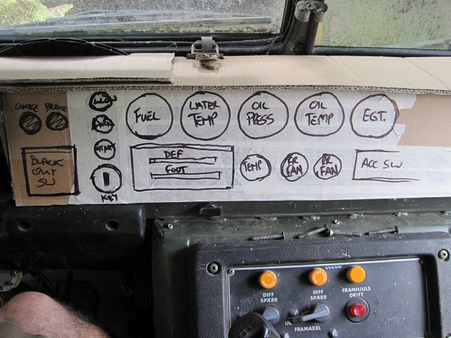

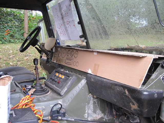

Have been playing with the dash panel. Now that the steering column comes out through the midde of the speedo some modification was necessary.
Usual mock up made - in cardboard this time.
Took a couple of attempts to get a gauge layout I was happy with. mostly due to retaining the heater control position due to cable lengths, as well as trying to find sapce for all the switches.
Will be running a combination of 12v and 24v systems, just to keep things unecessarily complicated, with most of the new stuff (gauges) changing to 12v.

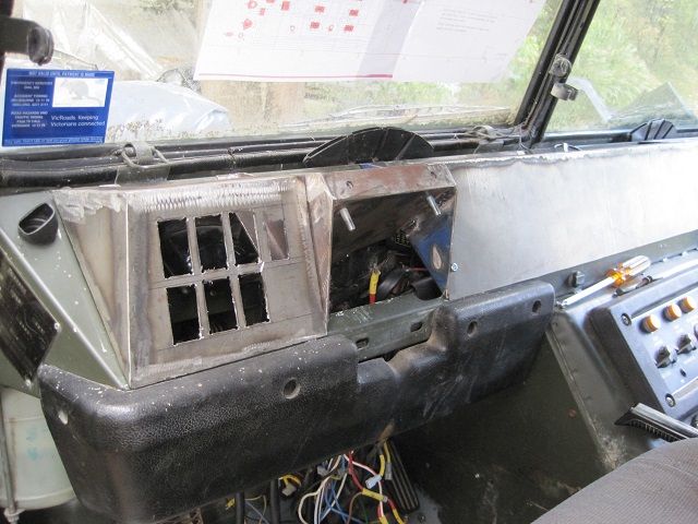

And now in steel...
Stick welding 2mm has been challenging, but pretty happy with the result. Went with steel as this adds some structure to the column. Now the column hangs off the dash instead of being attached to the chassis, adding in this extra stucture sould help prevent unwanted steeing wheel vibration - but only time will tell...
Fuses can be accessed through the glovebox (false floor to be added), centre section unbolts as this will make wiring up the new stuff much easier.
Eventually will add a top panel in ply, covered in vinyl, which clips down - I'll still need to access the brake reservoirs as well as the new expansion tank for the yet to exist water/air intercooler.
Now for the task of cutting all those switch/gauge holes...

And if you can make it HINGE open, your wiring will be that much easier, too. Or possibly make the center panel wiring all disconnect with plugs, so you can wire the panel away from the dash and then just plug it in when you mount it. Either of these options generally will save you time in the long run! Ask me how I know....centre section unbolts as this will make wiring up the new stuff much easier.
It's looking very good!

Hmmmm... I like that hinge idea... Pretty sure I could make that work too.

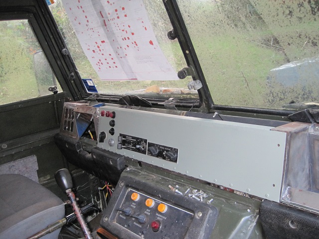

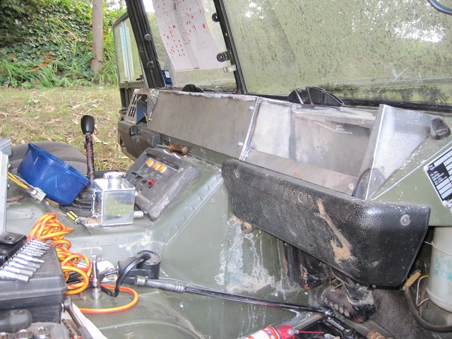

Just some tinkering this weekend, cut the holes for the switches in the centre panel. I don't have the gauges, so they will wait for the time being.
And yes - I added a hinge - and yes - that was a great idea!
I really wanted to weld the hinge on, but it was beyond my welding ability, so had to go with the pop rivets. Slapped a coat of primer on, and pretty happy with the result.

Re: Ian's TGB13 6x6 (Australia)
Can those two small bottles be removed from the space under the dash and the tubing run straight through without them? There are two additional filler caps outside for the washer fluid and coolant, I believe those are fluid and coolant also, just not sure why those bottles exist. Are they overflow chambers or something? Redundant? It would provide a lot more room to work under there if I could remove those without affecting the function of the systems.
If you look at them, its like they forgot to put them in during the engineering phase and stuck them on after production began. "In northern europe we put bottle where we needs. Is gud there."
Aren't those brake fluid reservoirs? mounted high to avoid possible water contamination?MadMax wrote:Can those two small bottles be removed from the space under the dash and the tubing run straight through without them? There are two additional filler caps outside for the washer fluid and coolant, I believe those are fluid and coolant also, just not sure why those bottles exist. Are they overflow chambers or something? Redundant? It would provide a lot more room to work under there if I could remove those without affecting the function of the systems.
roobar_and_custard
- Posts: 81
- Joined: Fri Sep 07, 2012 7:18 am
- Location: Melbourne, Australia
Correct - brake fluid reservoirs. Two, due to the dual braking system that the Volvos have. Don't fill these up with water!
The two caps on the outside at the front - Left = washer fluid, Right = radiator expansion tank.
I will need to access the brake fluid reservoirs, and will still be able to manage this now I have a fold down front.
Similar to the set up in a FC101 - the reservoirs need to be higher than the brake master cylinder which is high up under the dash. They are a nuisance where they are but there are not many options.
