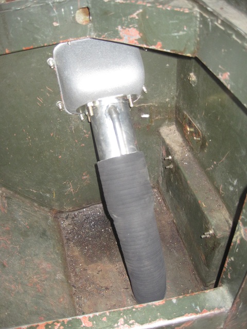

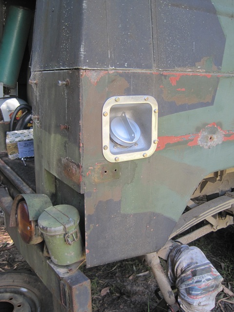

Let's start with an easy one - fuel filler. Time to get rid of the silly tin can.
Aluminum casting from the US, fuel filler/hose from a Land Rover which allows for Jerry can filling without an adaptor.
- Before.JPG (150.15 KiB) Viewed 19718 times
- During.JPG (130.04 KiB) Viewed 19718 times
- Inside.JPG (131.19 KiB) Viewed 19718 times
- After.JPG (134.26 KiB) Viewed 19718 times
- Extended.JPG (144.72 KiB) Viewed 19718 times

Any reason why the fuel filler was placed so High on the bed?

A couple...
1) I heard that the Volvo has a tendancy to leak fuel due to the low position of the filler relative to the tank - especially on side slopes.
2) Suited the hose length.
3) Would allow for an auxillary tank to be added between the filler neck and tank - possible later addition
4) Looked nicer (to me anyway).
And yes it is quite high... but still seems OK.

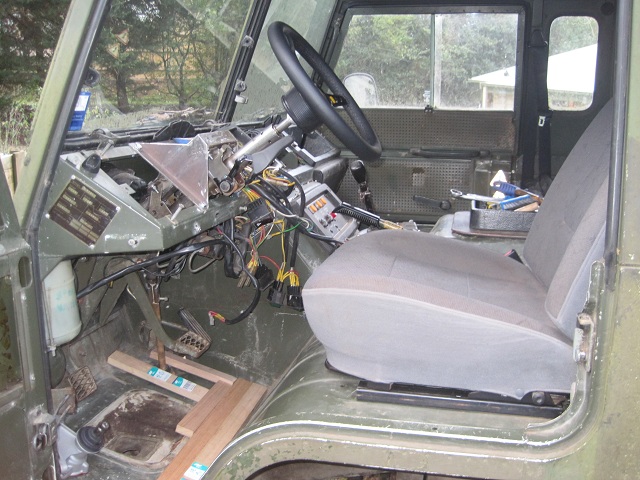

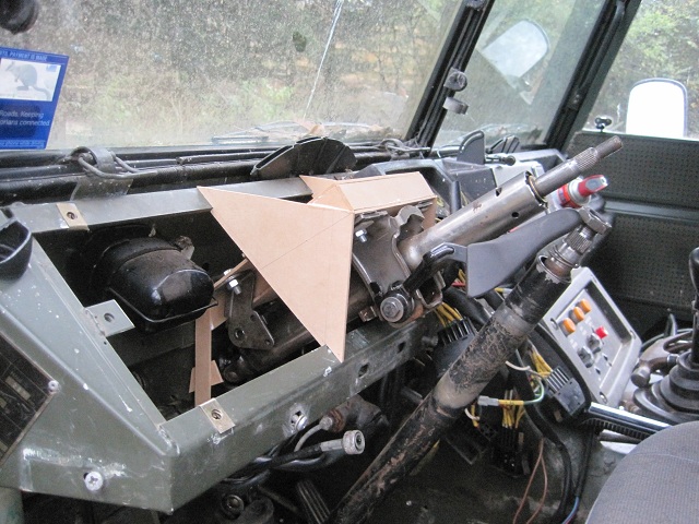

Upper column set up. Uses a Land Rover Freelander column on a custom mounting bracket, with plan for steering shaft to run down through floor ahead of accelerator pedal.
Gauges to be repositioned to somewhere else - yet to be decided.
This frees up heaps of floor space for your feet and avoids having to step around the column.
It also disconnect the column from the chassis which should help with interior noise levels, as the direct noise path is eliminated.
- Column comparison.jpg (127.92 KiB) Viewed 19582 times
- Prototype.jpg (147.88 KiB) Viewed 19582 times
- New Steering Bracket 2.jpg (138.11 KiB) Viewed 19582 times
- New Steering Bracket 3.jpg (120.01 KiB) Viewed 19582 times
- With Wheel.jpg (140.67 KiB) Viewed 19582 times

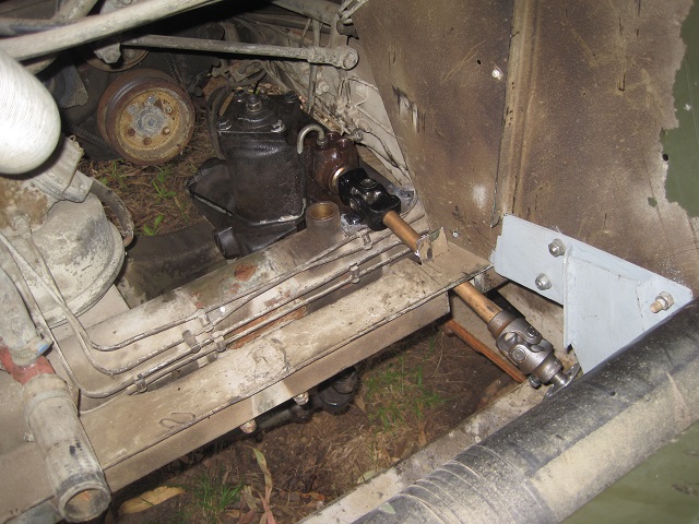

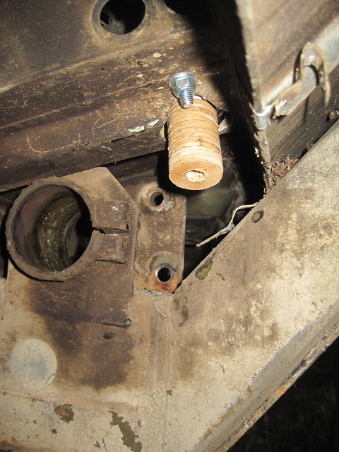

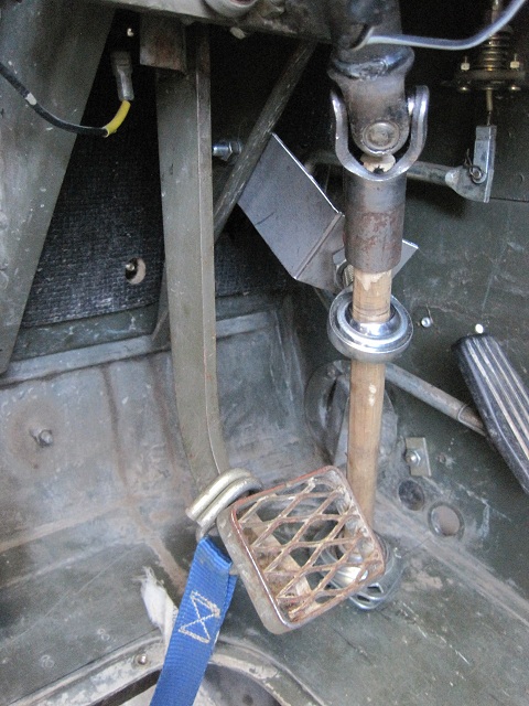

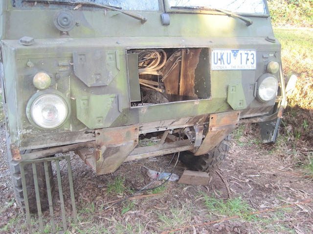

Lower shaft picks up from standard(unmodified) steering column UJ and drops out through the floor. It runs in front of the brake pedal and behind the accelerator pedal.
Sounds bad, but is actually well clear of your feet when operating the pedals.
UJ is very close to pedal box and intermediate shaft very close to master cylinder, but it all fits. It is a bit close the brake switch, but only a small issue.
Getting the alignment right has taken lots of fiddling and required two attempts at the top bearing bracket. And then multiple attempts at the lower bearing where it passes through the floor to meet the bevel box.
Lower shaft exits through the floor, and right through one of the reinforcements - which is a bit annoying, but not really a worry (last picture taken from underneath with original column/pitman arm removed).
And "yes" the wooden shaft will be replaced with a steel one...

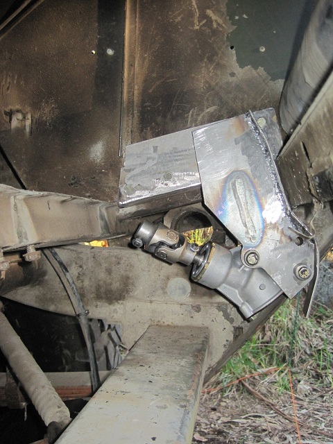

The bevel box sits under the floor and turns the steering input through 90degress(ish) to point rearwards towards the new steering box location.
Steering shaft from inside runs through a straight coupling here - no additional UJs needed.
It sits pretty close to the chassis at the moment, but as I am planning a small body lift (10-15mm max) to put isolator mounts between the body and chassis, then this will not be a problem.
Although it does sit within the profile of the chassis rails, a steering guard will also be added to the front to protect the bevel box from "off-road" damage.

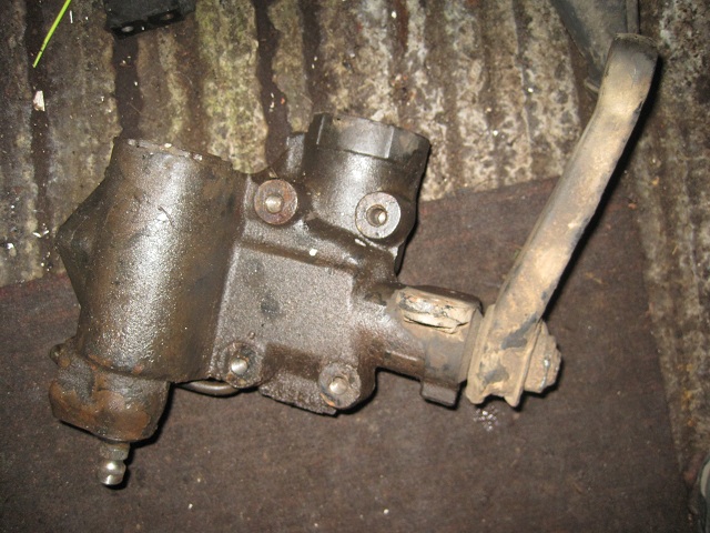

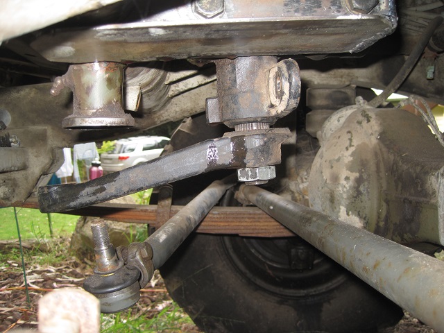

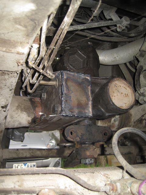

Steering box is from a RHD Land Rover Discovery, turned through 180degrees so the input shaft now faces forward, and with the pitman arm also turned through 180degress to correct the steering direction.
Number of turns lock-lock should now drop from around 5 down to around 3.5 - a much nicer proposition.
A new box section (replicating the original mounting) is then added to the back of the steering cross member for the steering box to attach to. Getting this position right took a little time as you need enough space for the UJ, but mustn't get too close to the sidewall of the footwell.
Steering shaft runs from the bevel box to the steering box, and once again - straight through a reinforcement!
Overall, pretty happy with the set-up.

Connect the drag link to the pitman arm - which needs to be shortened to match the original. I'm thinking maybe a rose joint and re-drilling the arm to suit, but need to check the legalities of this.
Rebuild the dash panel around the new column.
Cheers,
Ian.
