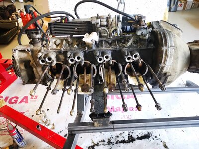

Got the engine out, built a stand for it.
Tomorrow I will be removing the cylinder heads, cylinders and pistons.
I'm not re-using them. Only things i will re-use are:
-push rods tubes
-oil return tubes
-bolts
Anything I should pay special attention too when i remove the parts ?

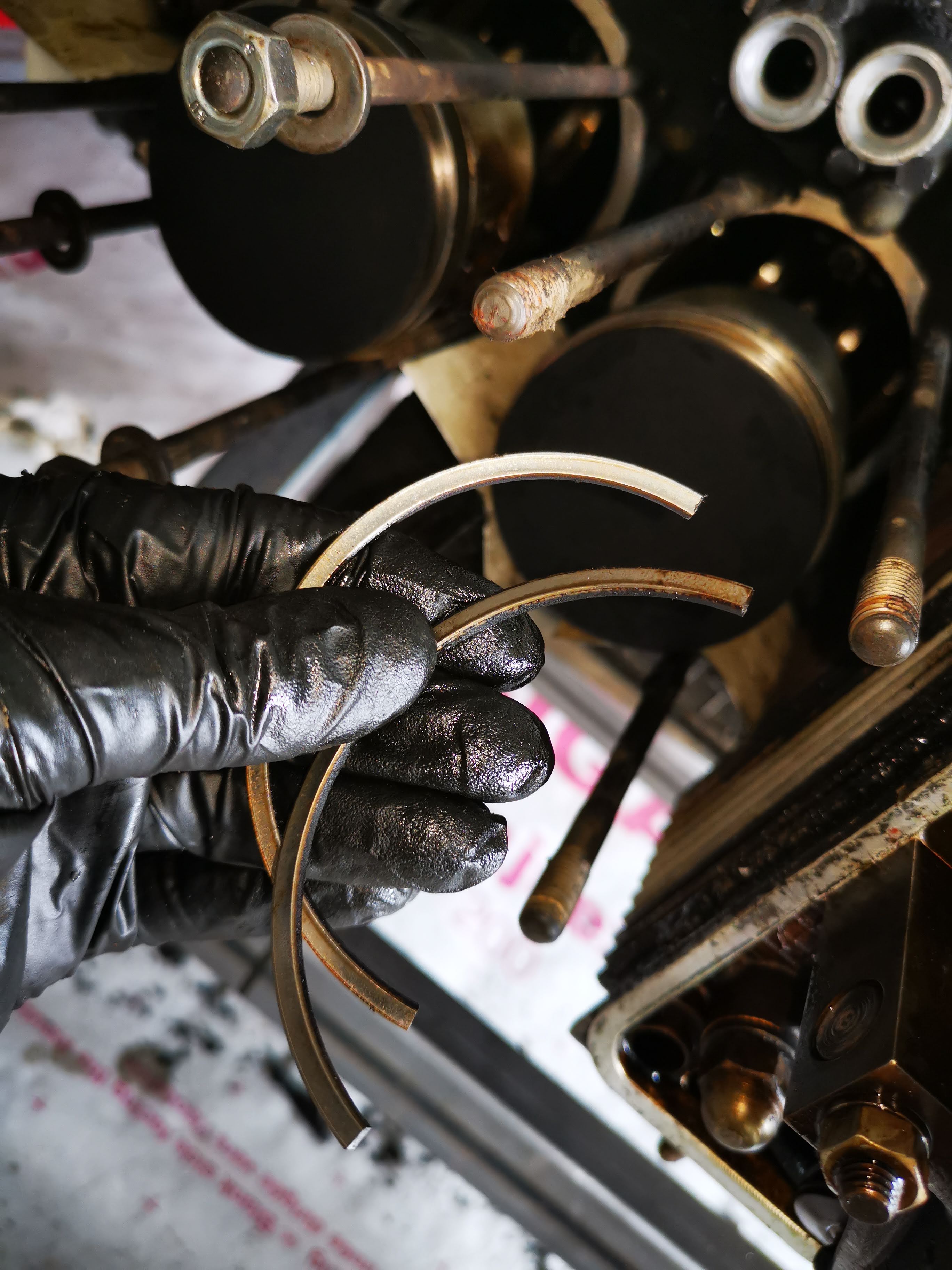

Ah ! I probably found the reason why my cylinder #3 was giving a higher leak reading on the tester:
https://pinzi-forum.de/viewtopic.php?p=116133#p116133
The first compression ring was broken in 2 :shock:
Cylinder #3 does not look very different from #1 and #2

Well, all heads, cylinders and pistons are out.
Apart from the broken compression ring, I didn't see any obvious damage, but I would need to measure the parts.
Now how do I remove these long bolts? They are quite stiff, I don't want to break them into the crankcase.
But I think it's better to remove them so I can better clean the surface that received the cylinder?
I think I will use 2 nuts held together? I sprayed WD40 at their base, but....
Should I apply heat around the bolt on the crankcase if necessary?
Can I use an impact drill? Or just manually?
