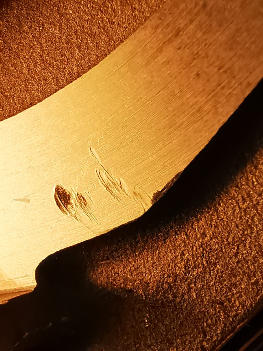

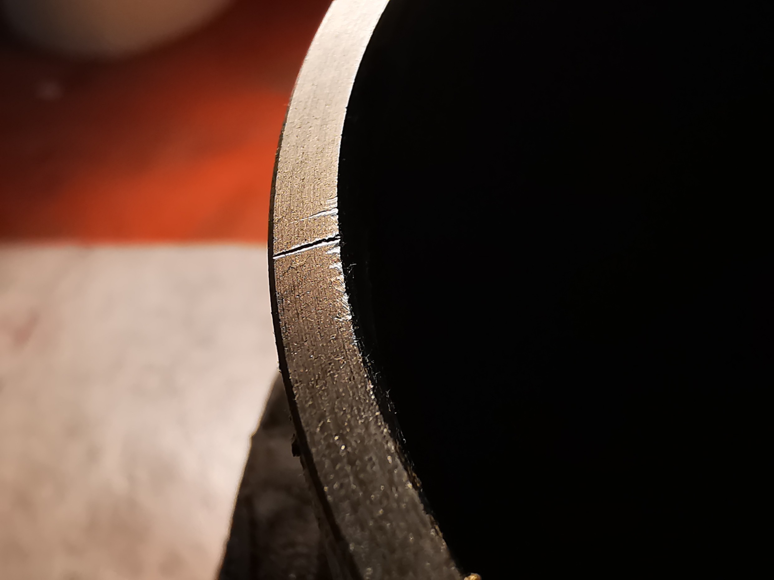

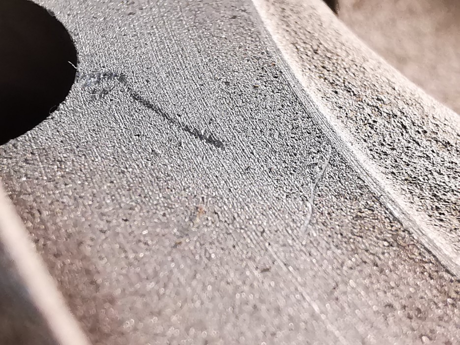

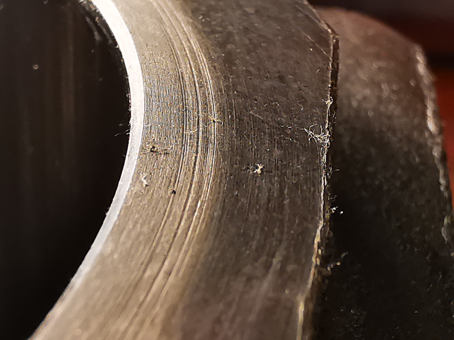

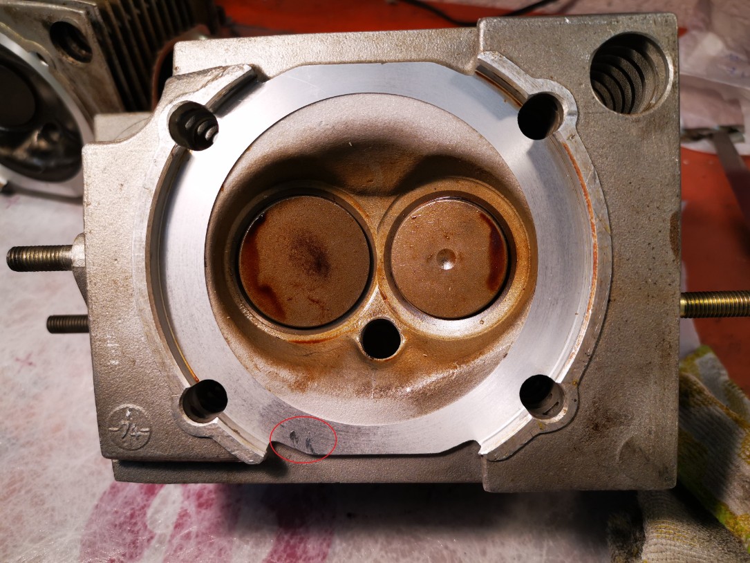

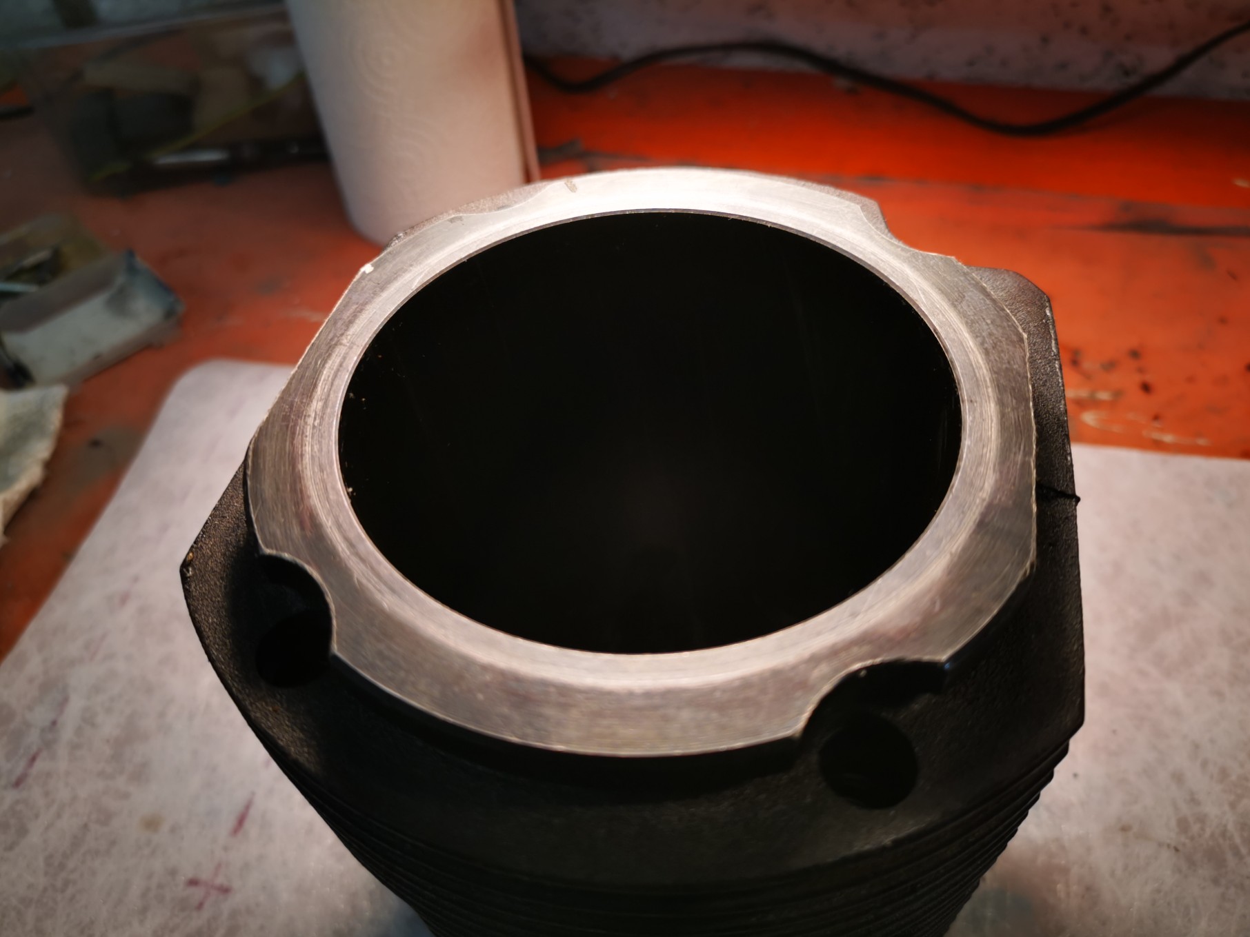

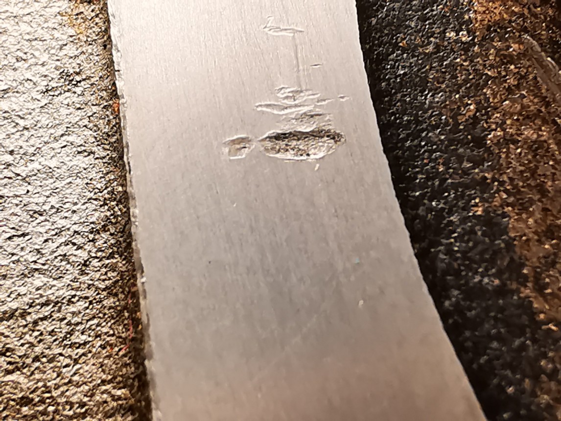

Was inspecting the parts S-Tec sent me today, I see some scratches and dents on some mating surfaces, see pics below
what do you guys think ?

Hugues
Posts: 185
Re: Changing piston, cylinders and cylinder heads
Post by Hugues »
some more pics
