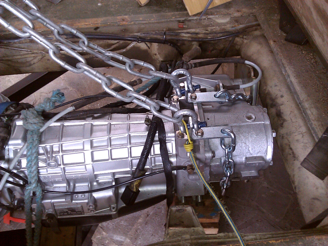

Hi Warren,
Currently my replacement engine and gearbox are sat on the floor and the original is still in situe. Time and space preventing much progress on this front (and most others it seems
). The pick below is of a similar set-up (300tdi/ZH4HP22/LT230), but one which has a hydraulic pump on the transfer case - which requires the cross member to be moved.
Based on some basic measurements, I am pretty sure I can make it fit without needing to move the cross member, but it will require a custom handbrake set up that hasn't yet been imagined...

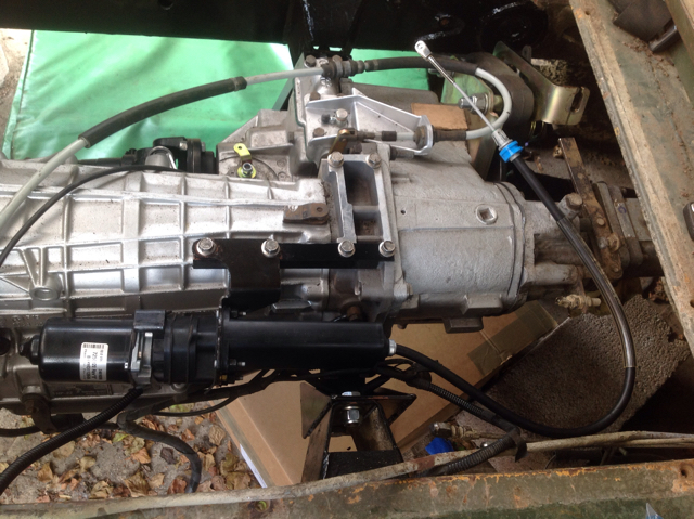

The 300tdi/hp22/lt230 setup will fit without removing the vac reservoir, if you shorten it to the max. However it's so tight up against it you won't be able to remove the gearbox or trf box without removing the engine too.
Here is the proof
Ps.Why is removing the reservoir such a problem?
Here is the proof

Here is my handbrake solution
- image.jpeg (406.56 KiB) Viewed 9149 times

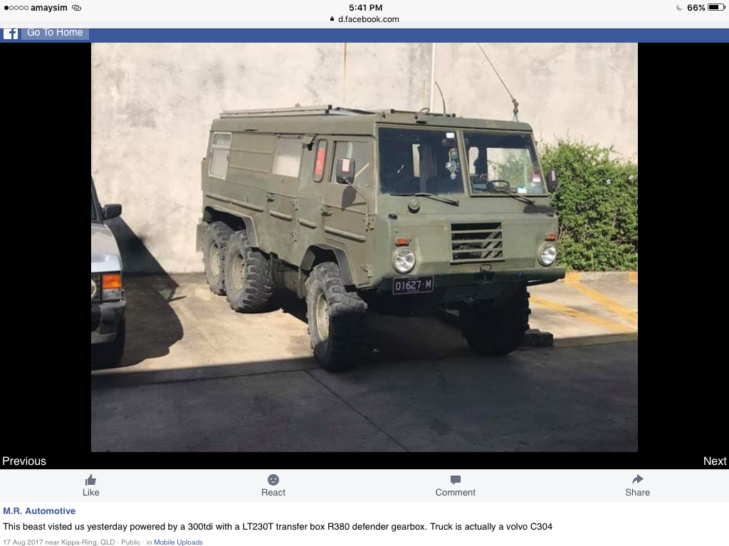

Gday Roobar, do you know anything about the Victorian club reg'd Volvo pictured? It has 300tdi, LT230/R380 conversion. And clearly XML's with offset/widened wheels...looks the part.
https://d.facebook.com/photo.php?fbid=1 ... n__=%2B%3E
Because this conversion has similarities to yours the owner could be possibly following this thread and see it pictured, then hopefully "own up" to building this beautiful Swedish beast. Hope you don't mind me using your build thread in this way.
Cheers.
Cheers.

Re: Ian's TGB13 6x6 (Australia)
I've seen this one pop up on Facebook a couple of times as "spotted", but I know nothing about it. It would be really interesting to know who owns it and what they've been up to (and if they thought the 300TDi was a good idea).
I gather they are on a tour or Aus...
