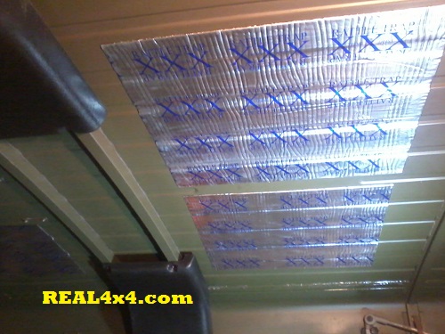

Above is a 710K ceiling being treated with Rattle Trap. This was covered over by custom trim panels which were then auto-carpet covered.

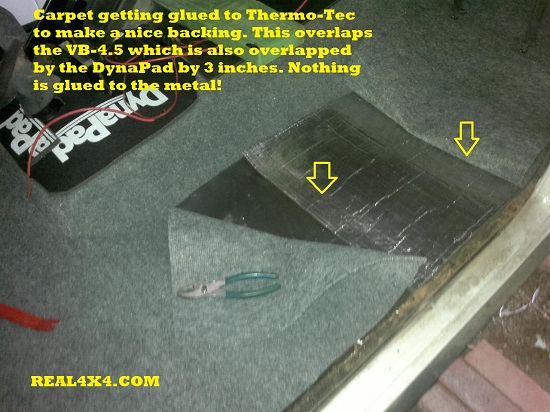

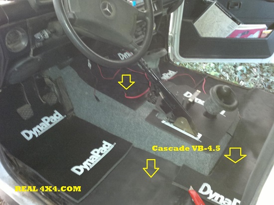

Above is a 300GD Gwagen getting a full floor treatment of VB-4.5 and DynaPad. The shifter area was covered as much as possible to reduce sound from getting past the control openings. The materials on the floor should always overlap so no air gaps are possible.
The key is total coverage and an "air-tight" approach. It should cover every bit of flooring you have, including under the seats and should not have gaps or holes except where 100% necessary.

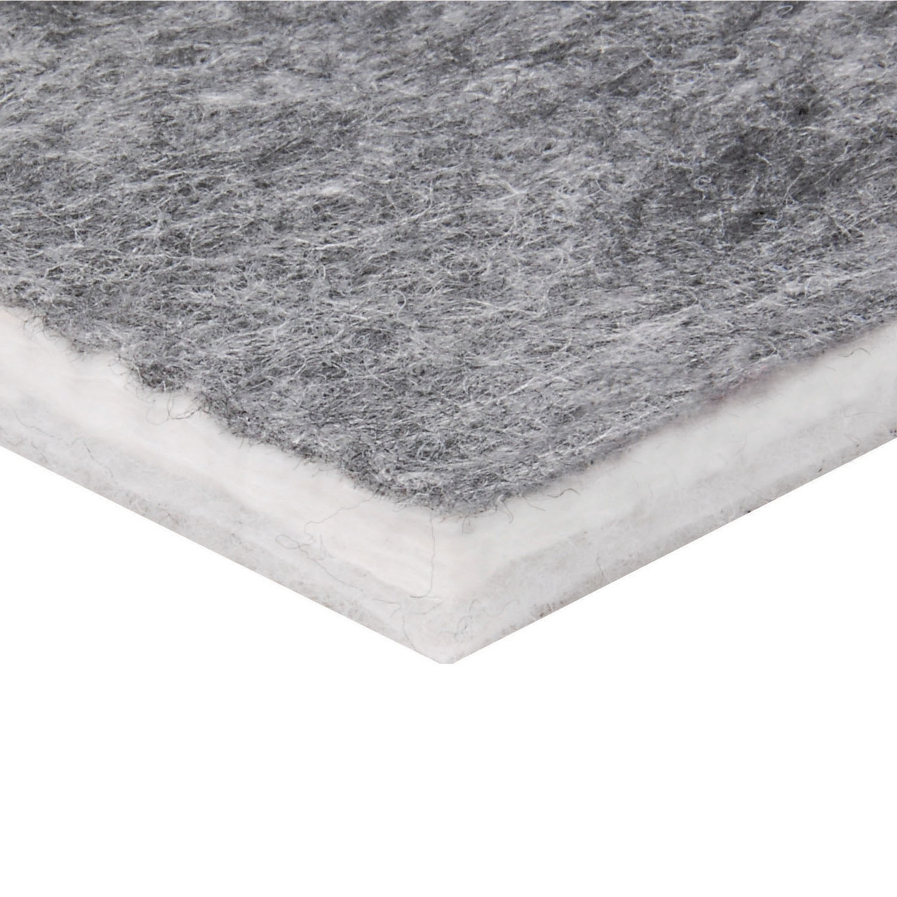

Another older but fairly effective material I use sometimes is Thermo-Tec. It's about 3/8" thick and is a mat made with syn. fibers with an aluminized outer layer. I use this as a backing for carpet and works great when you lay this over a high-end material like Dynapad/Liner Pro or just on top of the dampener making a poor-man's barrier product. It's also a great heat barrier and costs very little compared to the other stuff. I do not think it's very effective alone however.

I'm currently working with something new-to-me called 3M Thinsulate SM600L. This might be my new favorite bulk sound absorber for open cavities and hard to reach pockets, behind door panels, etc. It's designed to avoid water retention and block the mid and higher frequencies. In testing it seems to work very well so far. You can really take care of a lot of dead space easily with this stuff! It will also add some general heat or cold insulation.

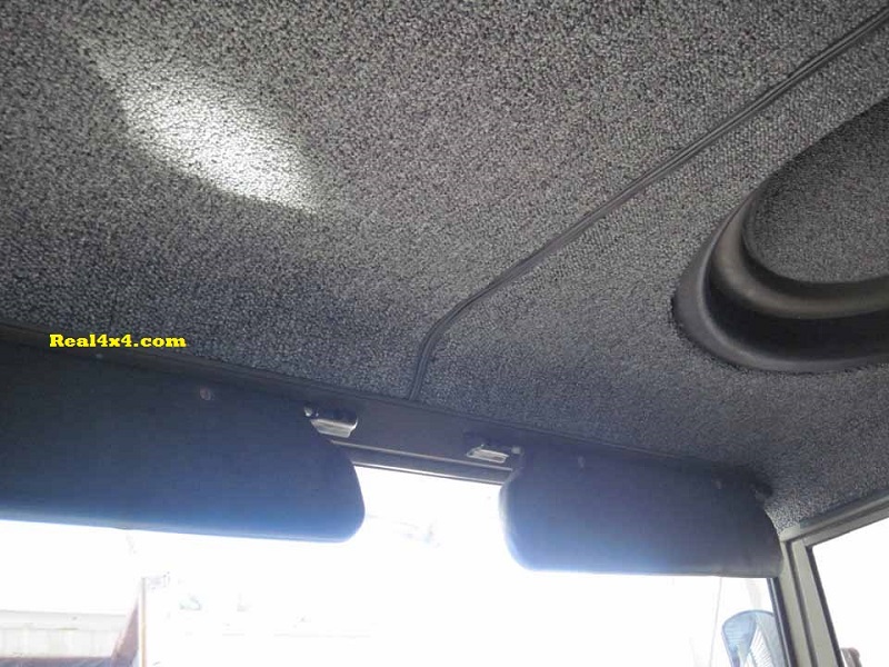

Above is a Volvo C303 that just had a custom headliner panel made. Under it is Rattle Trap to keep the roof from vibrating, in the middle is a sound absorbing and waterproof foam (in this case, Dynamat's HoodLiner foam) and an auto-grade carpet was applied over the panels for a night and day difference in the noise levels.

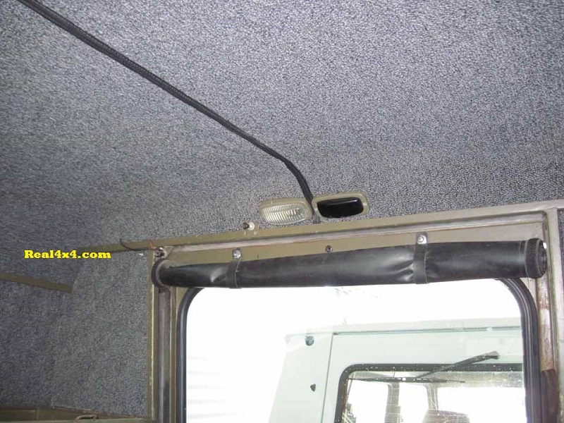

Above is the 710K's rear ceiling finished.

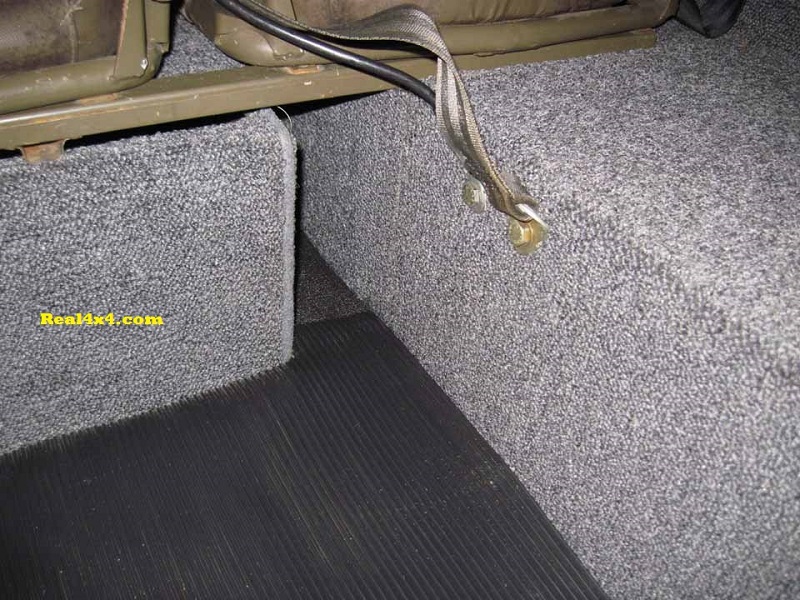

Are you referring to the floor pics above? That is in a Gwagen and when the seats are bolted back in, it holds down part of it. The area where your feet go is held in place because of the weight of the material, just like the floormats. It is sort of tucked around various irregular floor parts that hold it in too. In the case of a roll-over, part of it might fall but if that ever happens I have other issues to deal with. Being able to take everything out easily is essential for cleaning and drying in case of deep water or big spills.
In the case of the 710K, the rear material was mostly held down by it's own weight. In the front, the area behind your leg was well cleaned, dynamatted and then they used glue for the carpet. The roof was the same thing.
I will add 710K pics that I forgot about above.
Here's a pic of the back floor. The floor liner is the stuff from Heco and it's just laying there. It's dense and fairly heavy, like thick rubber, but it insulates sound, unlike solid rubber. And yes, after doing all of this I really wanted to have the seat brackets painted and seats recovered but that would have been way too expensive for that build.

Re: Sound Control: General theory and Pinz specific issues.
Vince, in the last picture of the 710K rear, is the floor mat the 1/2" Composite Barrier Floormat (07652-Black) or the 1/2" Floormat (07661-36" wide) (or 48" or 60")?
Also, is the carpet covering the sides and top of the wheel wells glued? Is there anything under the carpet?

It was the 1/2" floormat material from Heco (it's high quality stuff). Sorry I don't recall the width. The middle floor area was covered with the composite mat. The issue when buying is there's no way to order exactly what you need given the coverage needs. That's why the middle material where the passengers feet would go have the binding strips. We cut out what was needed and bonded a leftover piece to make it work. It ended up looking kind of nice though, I think. One of those strips is just for looks so it matches.
My thinking on using the floormat stuff for the back/cargo area was the length-wise ribs made sliding equipment in easier than the composite surface would have. In hindsight I may have ordered all floormat material. I guess I was worried about the ribs coming out uneven when I knew we had to cut/fit that middle part of the floor plus the ribs seemed like they'd trap dirt from shoes and might be harder to clean out. The budget kept me from ordering anything over the bare minimum so I couldn't play around at all.
Keeping in mind that the wheel well areas were 100% free of surface rust and fully painted, yes that area was glued in spots although not heavily; it could be removed without much work. Yes there was some Rattle Trap applied underneath but only on the vertical section where rust would be very unlikely to start. I think the pieces were about 7" by 12" and may have been doubled up since that is a fairly "tinny" area. You definitely don't need full coverage on any panel to stop vibration. I probably covered about 60% of it overall.
If I had the budget, I would have ordered the floormat barrier or VB liner to put under the carpet, and glued the carpet to it instead. The weight and seat/seat-belts, etc. would pretty much keep it down. You could just do a few spot glues then or velcro tabs, or even another mechanical bond of some kind. I had the idea that for next time, I'd embed rare-earth magnets into the edges/corners. I had some window curtains made like that for camping, with the magnets sewn-in, and it works great.

I've done 4 sound jobs on "K's" over the years and never seem to have the budget to really do it right. The upholstery shop, plus my time and materials all can add up quick so I understand but I think sound control is as important as seat belts, brakes, etc.. I'd love to really give it a try just once with the budget needed and do some sound measurements before and after to prove the benefits once and for all. I can dream.
The cab curtain would be nice if you made it from the sound blankets made for industrial shops to isolate loud tools/machines and service areas, which is a quilted fiberglass-based material. It would block and absorb unlike the stock curtain. An upholstery shop could cut put a window in the middle. Sewing magnets into the bottom might be a good way to seal it up quick, or velcro it. Enoise has them http://www.enoisecontrol.com/products/sound-curtains/

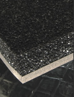

I just edited my old post with a couple updates. I recently "saw the light" when handling some new (or new to me) materials from 3M and Second Skin.
I take back some of my original thoughts on brands and will now only be using Second Skin dampening sheets. The quality is just so far above the usual that I see no reason to waste time on anything else. Also their Luxury Liner Pro is simply the best thing out there when it comes to sound barriers. All their stuff is USA made to boot!
The other and newest encounter was with 3M's Thinsulate Acoustic Insulation (SM600L). This is now my go-to cavity, headliner and door filler. I'm currently installing some on a 4x4 and it's actually fun to work with and easy to find, unlike certain foams made for the same basic purpose. There's also no smell, no itchy fibers when you cut it and its very compressible and flexible like a blanket. It's not cheap but I don't see anything competing with it. It's similar to what we know as "Thinsulate" that's been in our jackets and gloves for a long time but this is made just for the purpose of automotive sound control! It's also hydrophobic so water isn't sponged up and it comes on healthy sized rolls of 60" wide.
This stuff may be ideal in designing soft top mods for a Pinz. I could see it being applied underneath or sandwiched between the outer layer and a quilted, inner finish liner.
Oh and unfortunately Heco isn't selling sound control products anymore! This is a big loss but luckily alternatives exist.
I'll try to post some pics later.

I don't know how far you want to take it and what your budget is but I'd found out if you can reflect that heat first. You could mount a piece of aluminum spaced off the underside slightly over the exhaust pipe to take care of most of the heat. You could also try DEI's "Form-A-Barrier" underneath if you can't make up a reflector from alum. sheet. https://designengineering.com/formable-hard-shield/
If the heat issue is taken care of, I'd probably use Second Skin's Luxury Liner Pro on the floor, then glue or mechanically fasten an auto carpet and/or floormat material on top of that, like https://smile.amazon.com/gp/product/B008VIP5TE With that on top of the liner barrier, it would further reduce sound waves and provide a nice wear surface that's easy to clean.
If you still have heat issues or don't or can't reflect it underneath first, I'd look into DEI's "Under Carpet Lite", then bond that to a dense floormat like above. That would create a low budget, decoupled sound barrier product itself which can also handle heat. https://designengineering.com/under-car ... nsulation/
No one material will solve this issue that I am aware of. I think reflecting some of the heat underneath would be important first.
- 050110-UnderCarpetLite24x54-Front__29075.1497535960.jpg (323.58 KiB) Viewed 57436 times
- 011002-FormAShield1__36858.1510169193.jpg (207.92 KiB) Viewed 57437 times

I'd consider making a large removable floor cover instead of that rubber pad. The rubber is just transmitting sound waves right through it. It's not actually a good insulator for sound, especially without a decoupling material under it.
One of the Gwagens I did started with spraying the floor with rust inhibiting spray then making a floor liner with Second Skin Luxury liner pro covered with marine grade carpet. (like above) That made a huge difference. There's no replacing that layer of ML Vinyl.
To be effective for the Pinz cargo floor it should cover the entire area back there. It would be pricey to use that much material but not much else would work that well. You could take it out or lift up each half once a year or whatever and check for any signs of corrosion starting. The CRC or Blaster rust sprays should stop any of that though.
I'm about to start a major attempt by fully insulating a Unimog cab. I have some great materials from Second Skin including their newer gen "Mega Zorbe" plus I'm lining the engine area with some of DEI's heat liner foam.
