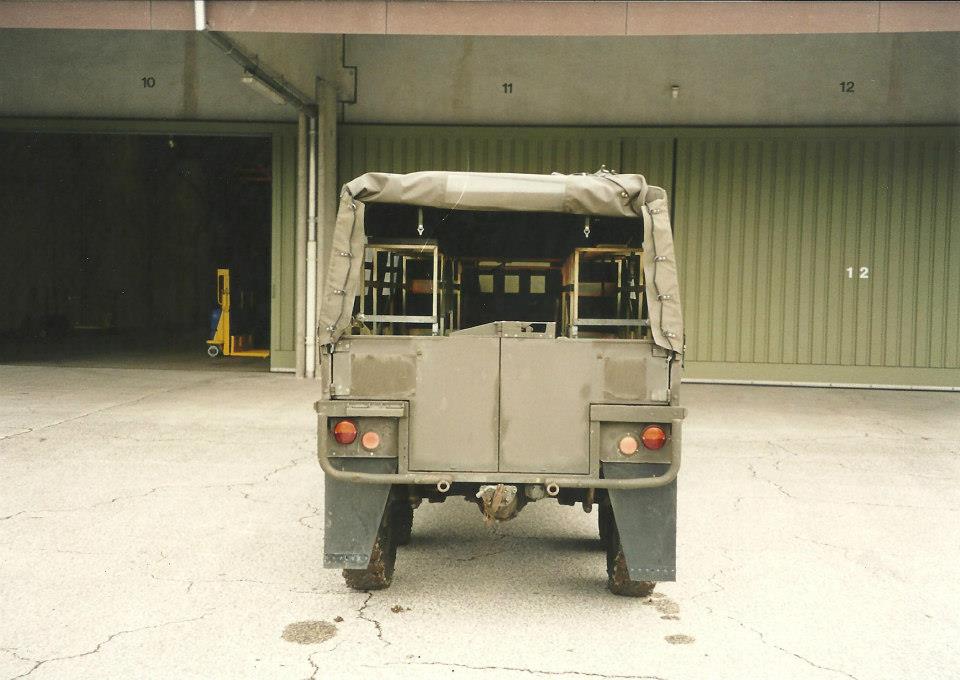

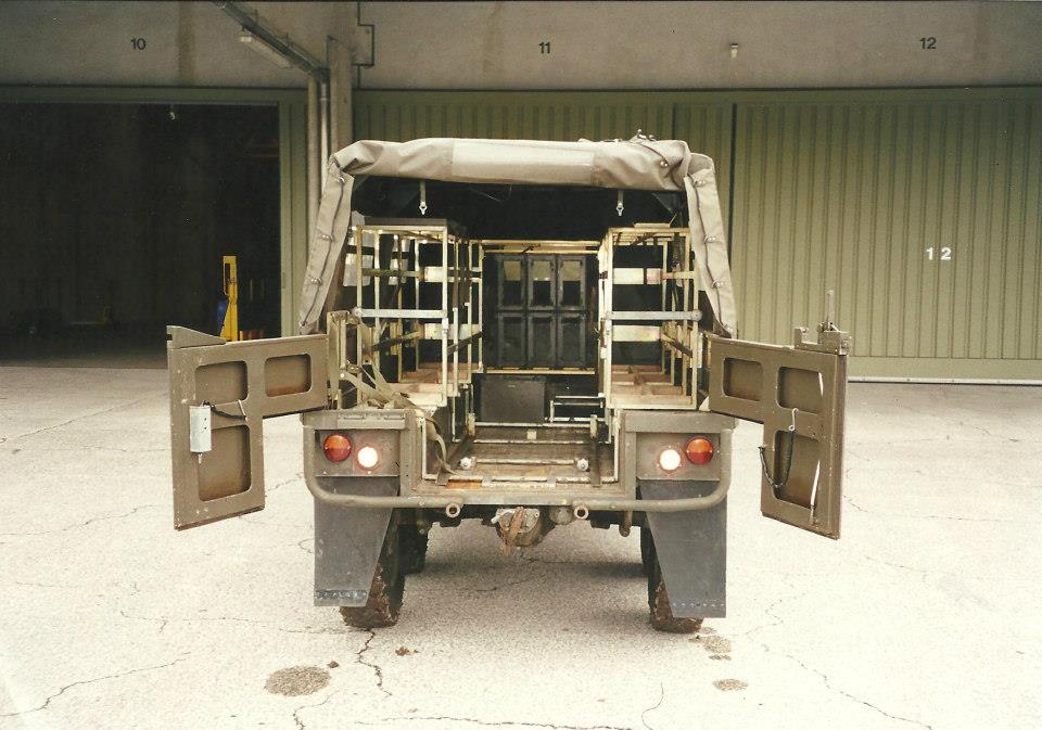

Barn doors is a great idea Jan!
GadgetPhreak, here are some pics in case you have not seen them before - they would replace your current rear door and the small side panels. Then all you would need to do is make a quick release for your rear roll bar for when you want to slide in the new alum box!

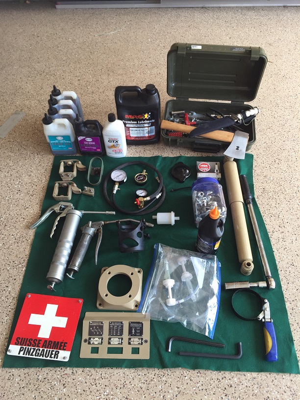

The seller just sent me this photo of all the gear he's found so far that is going in a bin and coming with the rig.
