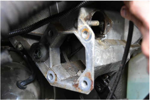

Once the booster is removed, the empty pedal box looks like this:
You can see the four square pattern booster stud holes, with the one that needs to be reached from inside the clutch master opening in the shadows in the upper left. Knowing that it is on the same level as the top rear hole will help you to find it.

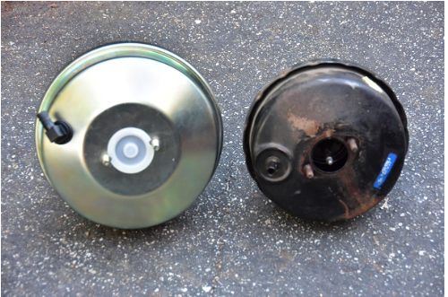

Interestingly, the replacement booster was slightly larger in diameter than the old unit:

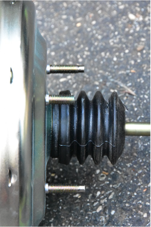

Installation is the reverse of removal; however, one stud is shorter than the other to avoid interference with the clutch mounting nut. This shorter stud should go to the top rear hole:

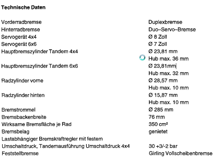

There is an excerpt from a german manual which says the 6x6 ues a smaller vacuum booster - 7 inch versus 8 inch.
Pinz brake info.jpg (139.95 KiB) Viewed 28723 times
Haven't looked at the english manuals to see if that is reflected there...
