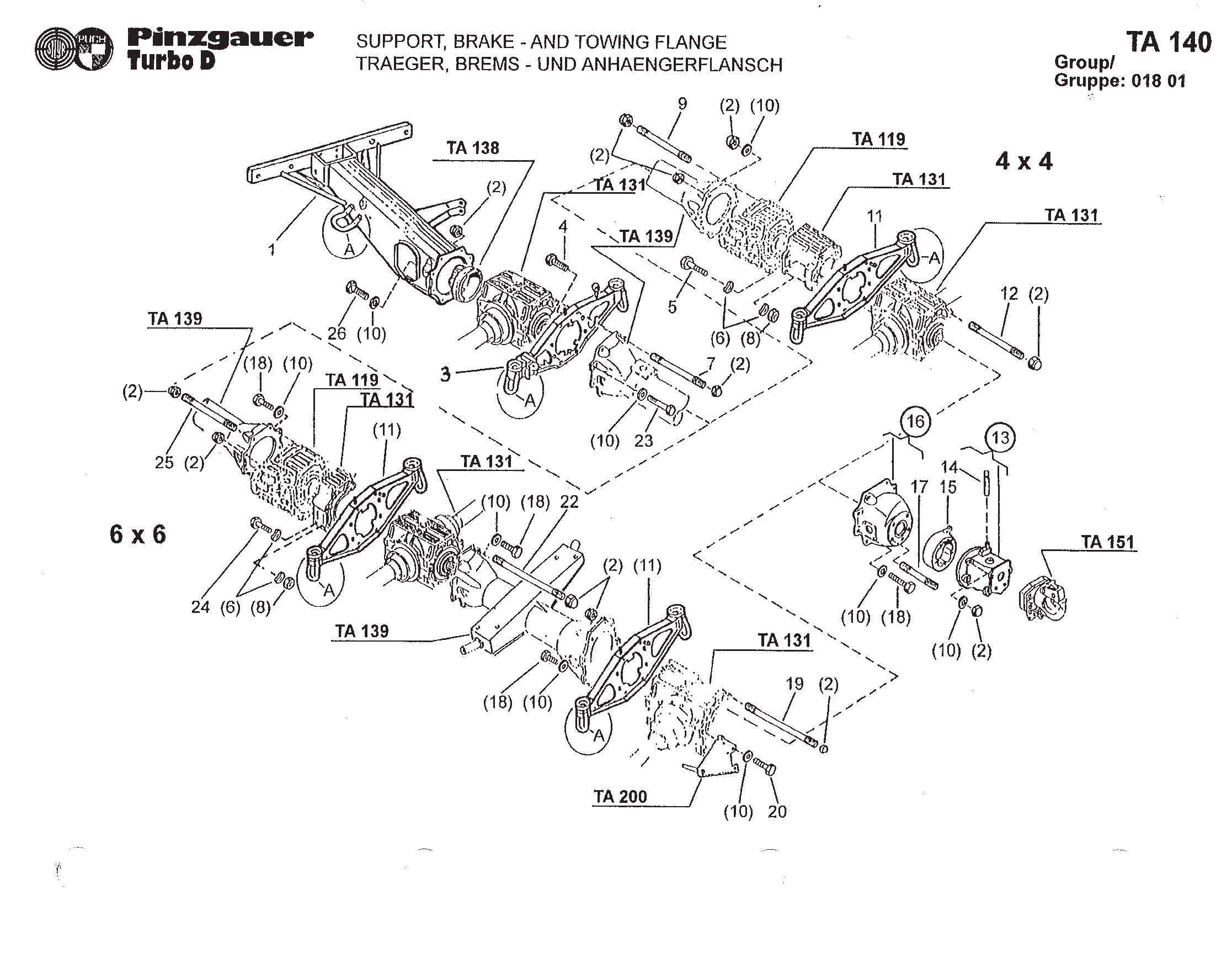

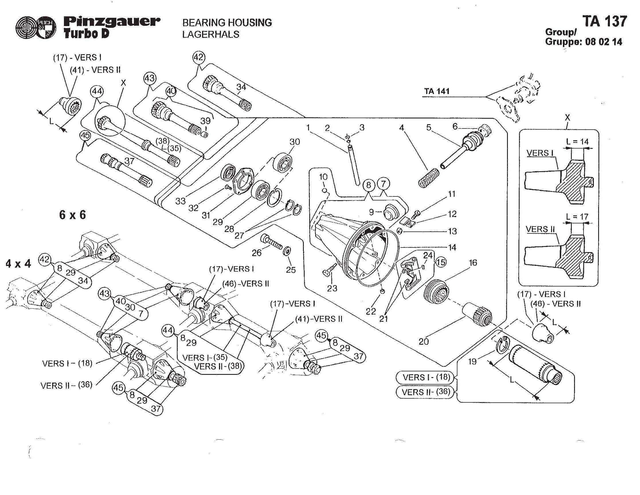

There are drawings in the SDP parts manual of similarity and differences between the 716 and 718.I need such a picture to clarify some engineering details (disk brakes, modular design aspects etc) and problems I'm having with the Engineering/Registration Dept here in Australia
These 2 drawings come to mind, and with the associated pages of the actual part numbers.
TA 137 and TA 140.
- TA 140.jpg (312.68 KiB) Viewed 8053 times
- TA 137.jpg (419.01 KiB) Viewed 8053 times
Re: 716 Chassis Picture
Thanks Dave, yes I have those pics in the Parts Manuals, but I needed actual images of the chassis to show to the Registration Dept Engineers real component parts.
