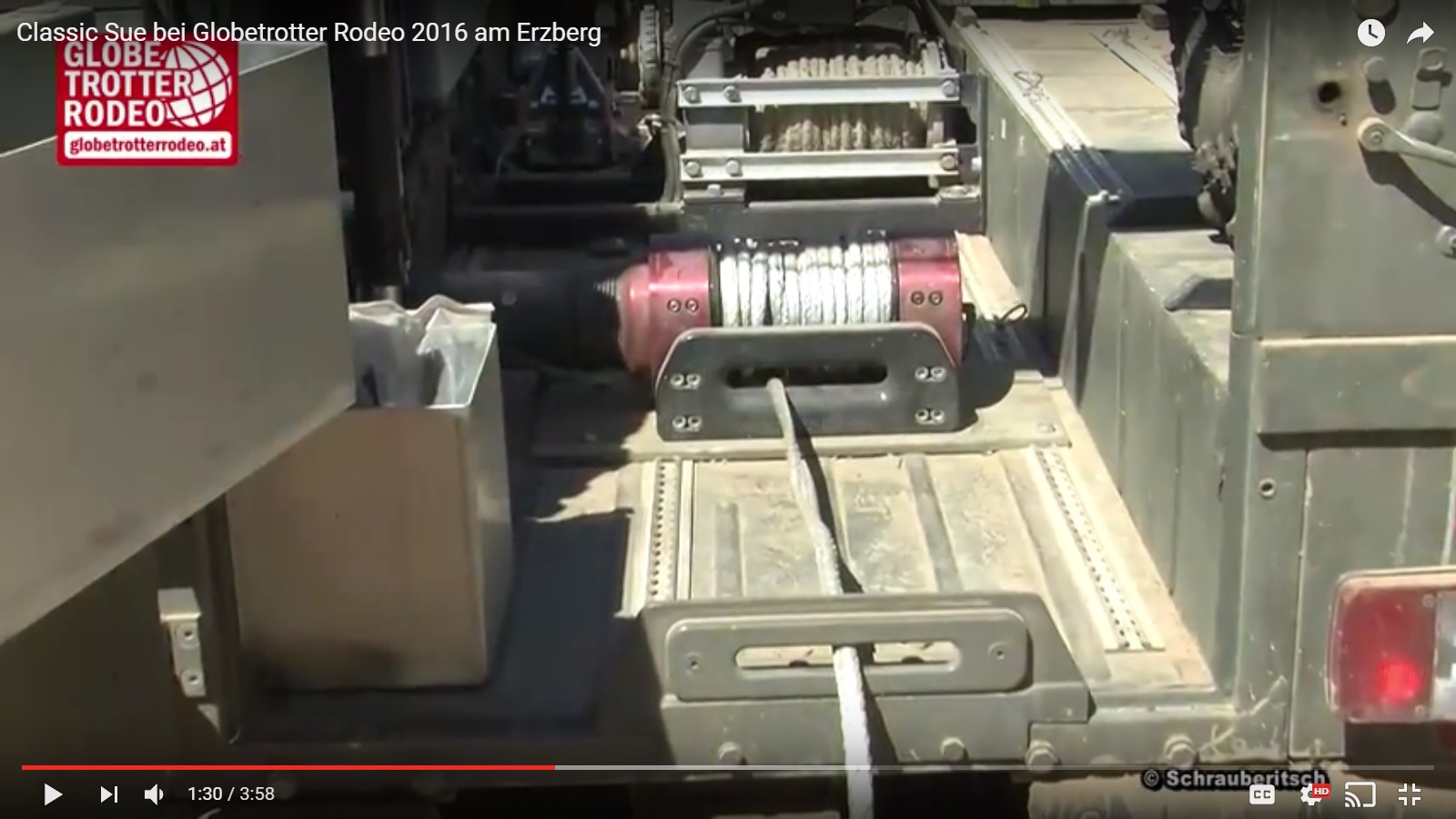

I saw a video from Classic Sue who makes competition parts for Pinzgauers and at one point in the video there was a photo of a pair of rear mounted winches in the bed of the Pinz 712.
Classic Sue Pinz Rear Winch.jpg (246.73 KiB) Viewed 10230 times
https://www.youtube.com/watch?v=36Ca56g118g
I also saw another photo of his Pinz with a tow cable coming out the grill -
Any thoughts on this? I would like to add a winch but not on the front of a 710 which is already nose heavy. Good idea or not?

"On the resulting open loading area are two powerful winches mounted. The first has a passage forward, the second a backward. The massive roll-over bar has two large "eyelets" at the front-top corners, through which the winch ropes can be guided, if the car must be secured sideways or it has to be re-erected after a drowning."

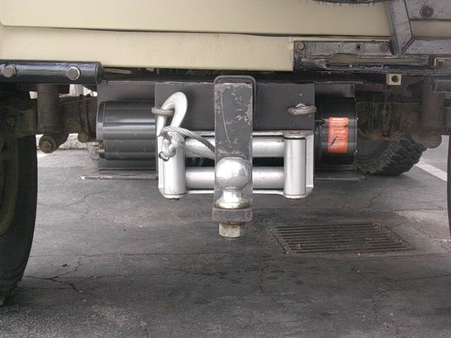

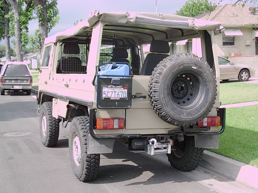

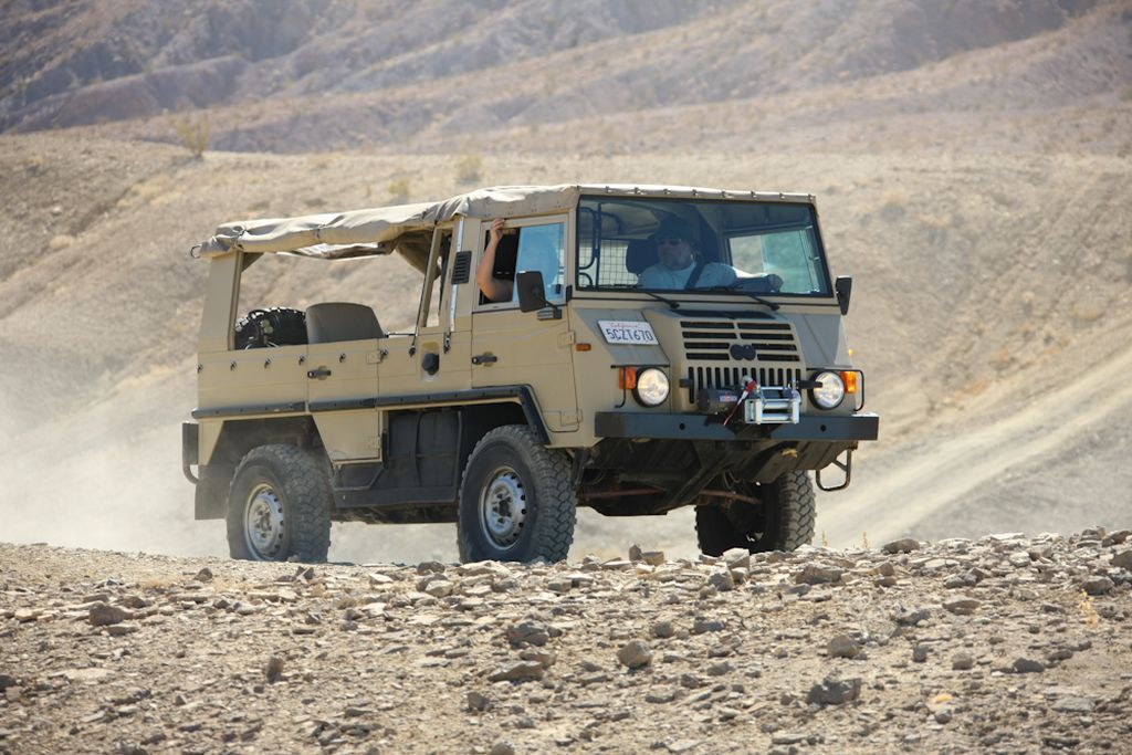

This a pic of the Pink Cow.
The tailcone needs to be milled down to 25mm (iirc), that allows the use of the original bolts and doesn't interfere with the operation of the parking brake. I also mounted a 2" receiver into the tray and it maintains the body to tailcone bolt. Unfortunately, I have never been able to locate the fab pics from the day.. :oops: I do remember that the bottom plate of the U tray was angled up to increase the angle of departure.
I also had a 2nd winch in the front on the PC. I had for years thought of spooling a winch from the rear to front but never dug deep into it, but could be done with pulleys.

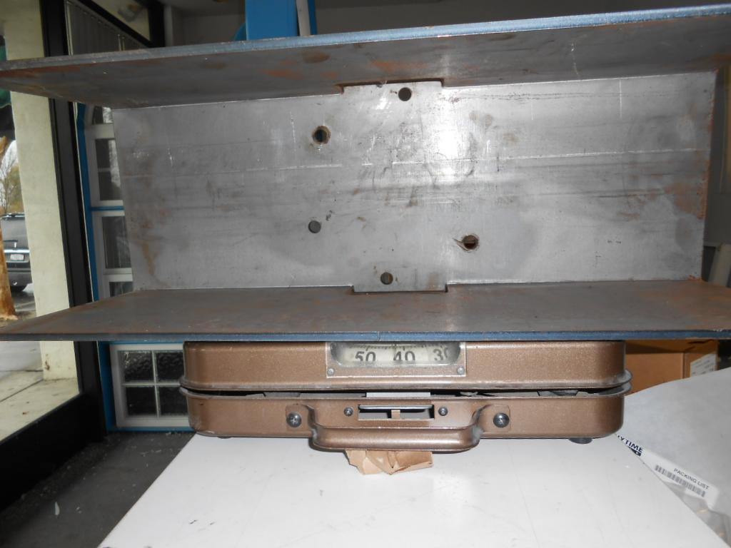

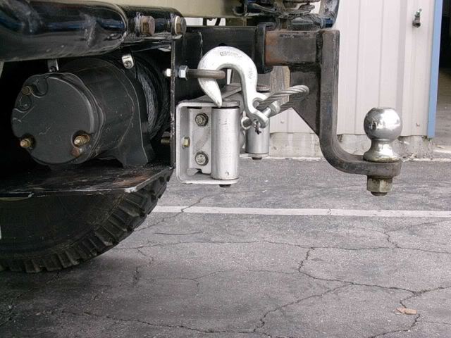

This album on my photobucket has a few pics of the mount and the 2nd page has pics of the basic tray with the holes for the tailcone bolts. The cutouts at the top and bottom allowed for a slightly smaller overall tray height and ease to mount fasteners. The body mount bolt are in different location between the gas and diesel Pinzes.
A plate was welded to the open end of the channel for mounting the fairlead.

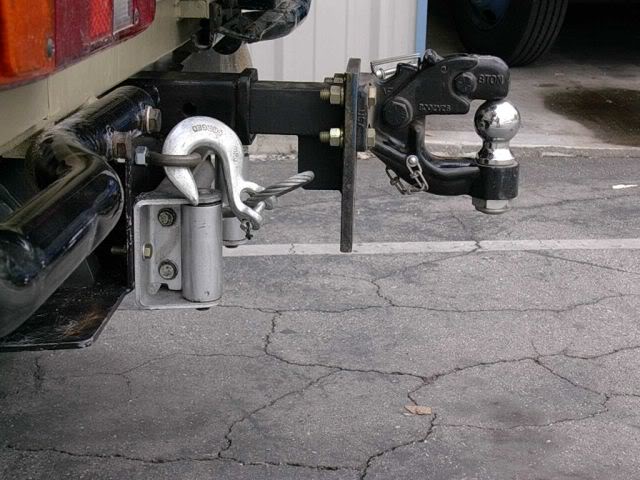

Here are a few pictures of the rear mount which was done by Gut in Zurich, providing them with quite a few pics of the Pinz Cow for inspiration.
They did not build a complete "box" structure, which made the top part (holding the pintle) a lot less sturdy than David's design, and they recommended that it only be used for the lightest of on-road towing applications, which I was not happy about (picture taken at the end of a winter when the truck did travel on gritted road. Instant rust as a result...).
...so I ended up modifying the part that supports the fairlead (and which is bolted at the bottom with the four bolts that hold the winch) to extend it up so that it also bolts at the top with the 4 bolts that hold the pintle, thus closing the "box" and with 1 centimetre (over a third of an inch) thick steel, significantly rigidifying the whole assembly. It is the green triangular part between the fairlead and the pintle on this picture (not the best picture of the winch, but I don't have another one and it's dark outside...)
At that point I had repainted the winch brake cover and added a thin steel plate to try and protect the winch from dirt/gravel/water projected from below.

It has been over 12 years since I had designed and made the mount, but would like to inject a few thoughts that had gone into its design ( what I can remember that is :roll: )
I had the tailcone milled down to approx 1” (25mm) so the winch tray was mounted directly to the centraltube using the original bolts. Only the pressure plate area for the parking brake was retained.
My first thought was for the tray to only be wide enough to fit the bolt pattern of the tailcone but did not like the idea of the winch being exposed to damage from rocks and debris on rock climbs, hence the full width tray to protect the complete winch..
Towing was always part of the requirements. The top portion of the channel was notched for the receiver tube to extent a bit above the tray and back into it, just a little behind where the rear body mount was in the tailcone. The receiver tube was welded on both side of the tray, and on the notched in the fairlead plate on the rear. This way all stresses are on the central tube and body as originally design.
As you can see in the last pic, the tray was not light, but in the rear of the truck it didn't need to be and strength and protection were key. That pic was of a 2nd tray that I had made and sold a few years back.

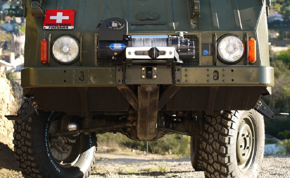

Just mount it up front. It's far easier to do, costs 10 times less, it won't ruin the resale value of the truck and it doesn't need to be heavy at all. Use a mount like the one I added where it's just enough to hold the winch. Andre makes them. Use syn. rope and an alum. fairlead and you've added very little weight.
That set up above is useful for racing but not much else that I can think of. In recovery operations it's a dangerous approach I think. You need to be able to see your winch and deal with the clutch, etc..

VinceAtReal4x4s wrote:Just mount it up front. It's far easier to do, costs 10 times less, it won't ruin the resale value of the truck and it doesn't need to be heavy at all. Use a mount like the one I added where it's just enough to hold the winch. Andre makes them. Use syn. rope and an alum. fairlead and you've added very little weight.
is just the airflow restiction what worries me... :cry: :cry: a front bumper winch takes the whole grill space!!

The airflow thing has been discussed to the end of the earth on here. It has absolutely no effect on airflow at all and is 1000% safe to mount a winch like that. There's evidence of 40 years of mounting winches up front on air cooled pinzgauers as proof. It's has never had an effect, even on the Croatia racing truck which was tested further than anyone on here can put a Pinz through after three races and lots of road miles. The fan way overpowers any "blockage" that is perceived.
I was referring to the bed mount and making a path to run a cable, etc..
Re: Rear mounted winch with cable routed to the front end
As Vince has said, airflow restriction is an non-issue. With so many trucks in the desert southwest, often running around in 110+ F (45+ C) temps, no one has reported a problem.
