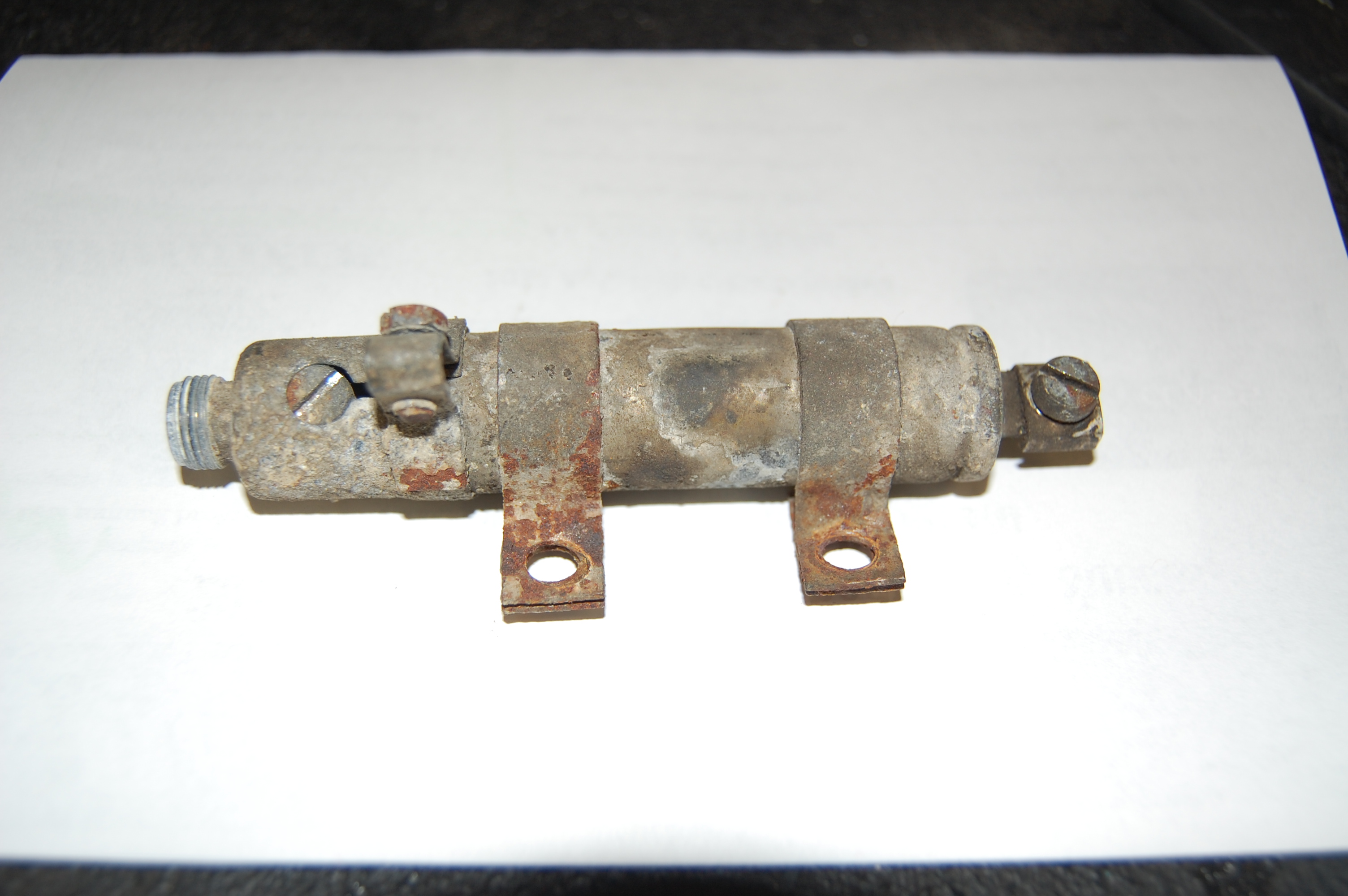

Could someone please explain what the operating voltage of the ignition system primary circuit is supposed to be on a 1974 710K, I am assuming that it is supposed to be 24v but I only measure a little over 9v (running). The service manual indicates 24v and the stock shielded coil has 24v stamped on it. Also: what is the purpose of the in-line cigar shaped metal canister in the primary positive circuit to the coil? It is mounted near the coil itself. Any information at all would be much appreciated, technical details are ok.

The item you pictured is a noise supressor designed to help eliminate hiss and other ignition noise on radios. You can remove it from the circuit if you prefer with no ill effects.
You are correct that the voltage should be in the 22-26 volt range. Items to check would be the voltage regulator and the VDO rpm limiting module. A search of the forum should provide you with plenty of suggestions and instructions on what and how to test these items.

Re: Ignition System Voltage
