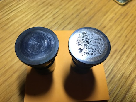

I believe the Calcium and Boron levels are indicative of a detergent based oil. The Iron levels are pretty darn
low -- which would imply your rig didn't sit for months at a time resulting in corrosion or oil was changed recently
before your change?
The part to be a bit concerned about are the metal bits which is quit possibly from lifter pitting. This may be
a sign of using -- for a lack of better terms -- "street" oil for many years. What should be used is one of three
Oils; Diesel engine oil class "CJ", ashless Aircraft oil, or Oil designed for classic cars (with solid lifters). Today's
car oil lacks sufficient anti-wear additives e.g. ZDDP (it is a Poisson for catalytic converters thus the significant
reduction in ZDDPl). Diesel engines are still considered high wear and oil has maintained the proper level of
ZDDP -- at least for now, read the label and safe with CJ. Aircraft engine oil -- which I use, requires proper
anti-wear as specified by the engine companies e.g. Lycoming etc.you don't want engine failure at 10,000'
Here's a PIX of a good and bad (pitted lifter) -- the metal bits go to the bottom of the sump. See if your debris
looks like small "chip-outs". BTW the cam can wear flat but typically doesn't. The point force on the surface of
the lifters is incredibly high. Lifters today are rollers.
