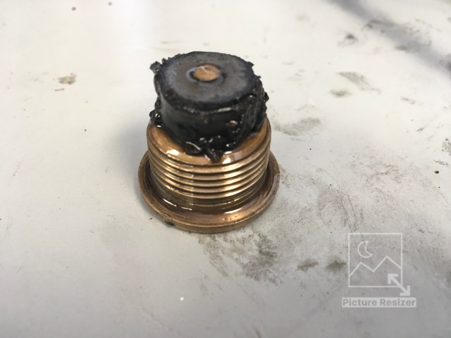

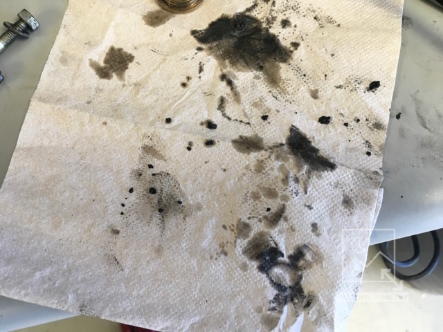

Sorry the pics are out of order. I did first oil change on my Pinz after picking up a couple of oil filters from Scott at Expedition Imports and you can see what came out on plug. The reason for change was oil level was high. Drained out 8 quarts of oil. A few weeks ago I drained a quart and half and sent it in for some ianalysis. Oil analysis indicates fuel in oil but was not expecting to find metal particles in the oil. Engine appears to run fine, a bit rich,
Any ideas? I do not see anything unusual with the carbs leaking. Fuel pump?

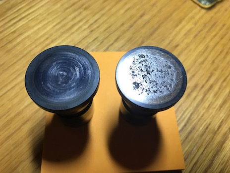

Recent posting one of the forum members had. He noticed a fair amount of gas in the oil which was due to a
leaky diaphragm on the fuel pump, Might want to dig into that one.
I believe the Calcium and Boron levels are indicative of a detergent based oil. The Iron levels are pretty darn
low -- which would imply your rig didn't sit for months at a time resulting in corrosion or oil was changed recently
before your change?
The part to be a bit concerned about are the metal bits which is quit possibly from lifter pitting. This may be
a sign of using -- for a lack of better terms -- "street" oil for many years. What should be used is one of three
Oils; Diesel engine oil class "CJ", ashless Aircraft oil, or Oil designed for classic cars (with solid lifters). Today's
car oil lacks sufficient anti-wear additives e.g. ZDDP (it is a Poisson for catalytic converters thus the significant
reduction in ZDDPl). Diesel engines are still considered high wear and oil has maintained the proper level of
ZDDP -- at least for now, read the label and safe with CJ. Aircraft engine oil -- which I use, requires proper
anti-wear as specified by the engine companies e.g. Lycoming etc.you don't want engine failure at 10,000' :wink:
Here's a PIX of a good and bad (pitted lifter) -- the metal bits go to the bottom of the sump. See if your debris
looks like small "chip-outs". BTW the cam can wear flat but typically doesn't. The point force on the surface of
the lifters is incredibly high. Lifters today are rollers.

When I first changed the oil in my trucks, there was quite a bit stuck to the magnet. Now I get just a little bit, every time I change the oil. Seems common as both my trucks have a small bit - one with a completely stock engine, the other with a 2.7l conversion, cam and compression change. Wipe off the magnet and see how much is on it for your next oil change.

Thank you all for the info, yes the particles do look like they are probably off lifter. I will check fuel pump today.

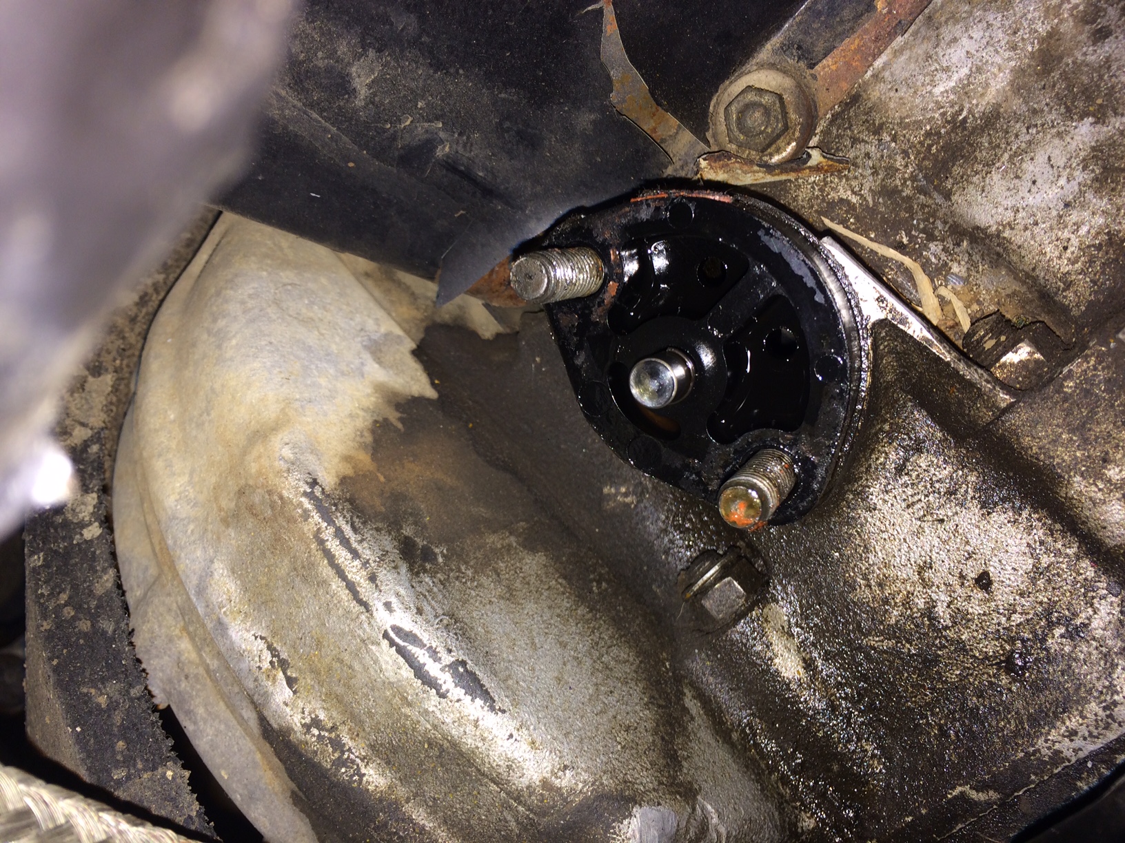

I pulled fuel pump.
Took fuel pump apart, diaphragms look pretty good no crack or holes visible. Should have Napa auto part replacement installed this afternoon.
Picture of area under pump was not really loaded with fuel as I was expecting. Now I am not so sure of pump causing fuel in oil. Should area under pump be completely dry?

I'd say if you touch it and smell it and if it's fuel you should replace the pump. I believe there are a couple of small holes in the plastic base, so fuel might drain into the oil through those.

I'm having second thoughts on whether my fuel pump was the reason for my fuel in the oil. We took our suspect pump apart and the diaphragm was fine. I also noticed the leak hole in the bottom of the pump bowl which is to indicate that if the diaphragm was leaking we should have seen fuel drip out of that hole, and we have never seen that happen. If the two small holes in the plastic spacer allow engine oil to enter the bottom of the pump, the fuel smell I got from the underside of the pump and top side of the plastic spacer might have been fuel in the engine oil.
Is there any other way a fuel pump could be leaking fuel into the oil if the diaphragm is good?
