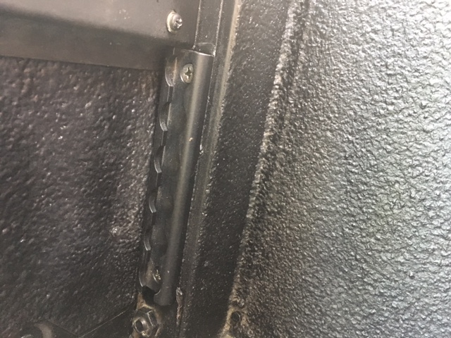

With that said, I chose to use L-Track like they use on planes for the seats and on buses to strap down wheelchairs.
Not saying this is what you should do but it is better than mounting E-Track incorrectly!

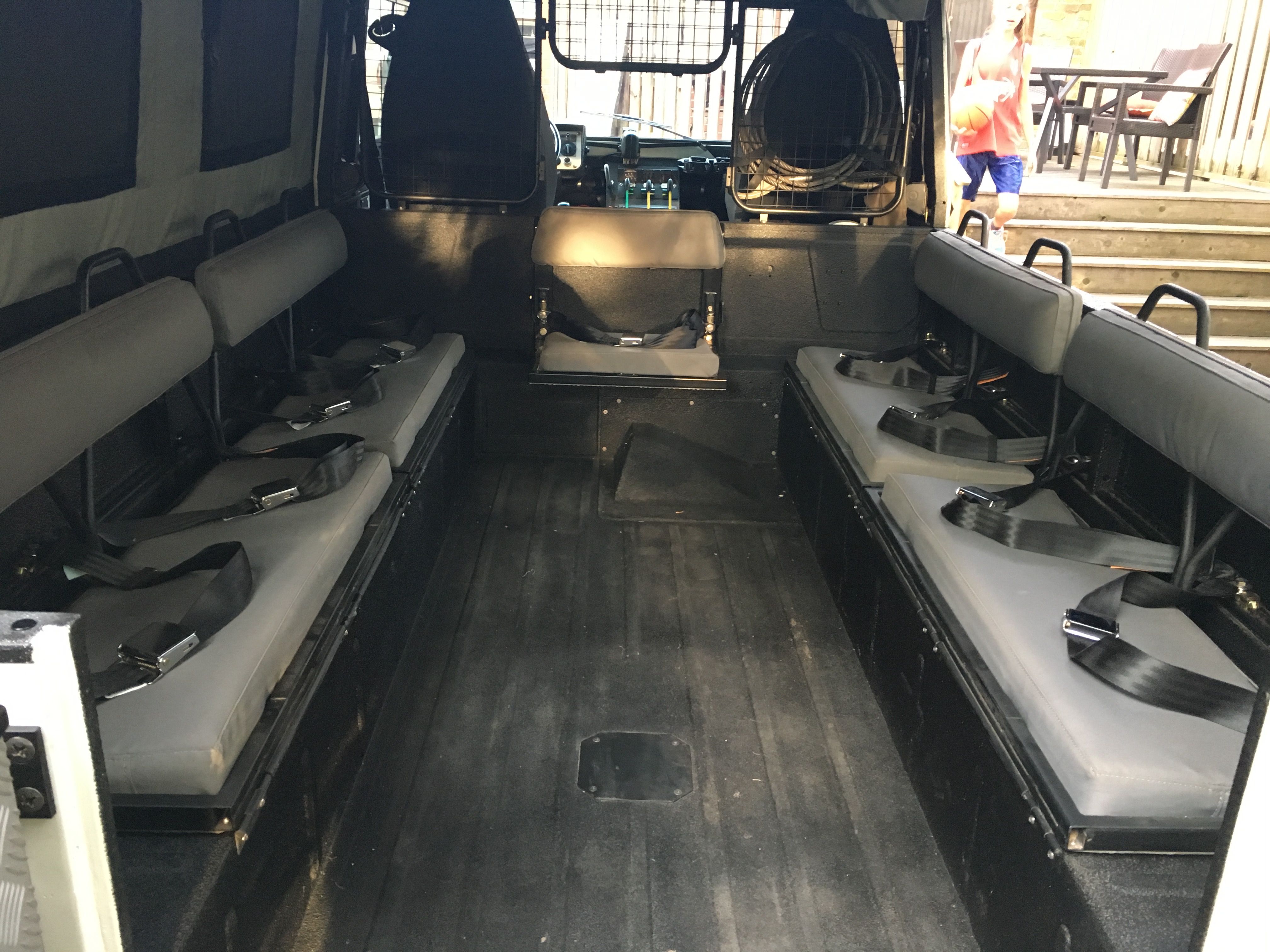

Here are some pictures of how I had Andre install it:
Runs all around the outside edge of the side boards and is screwed into the bed every 5"

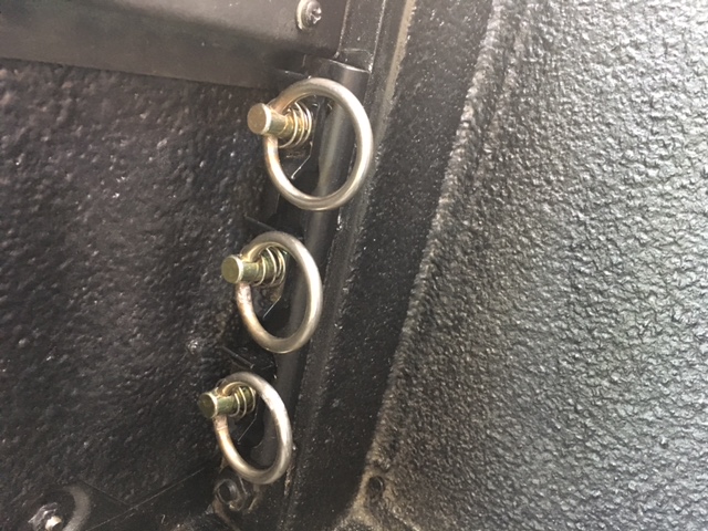

Each double seat-belt fitting has a WLL of 1,333 LBS and Break Strength of 4,000 LBS
Also runs around the rear where I can store extra attachment points

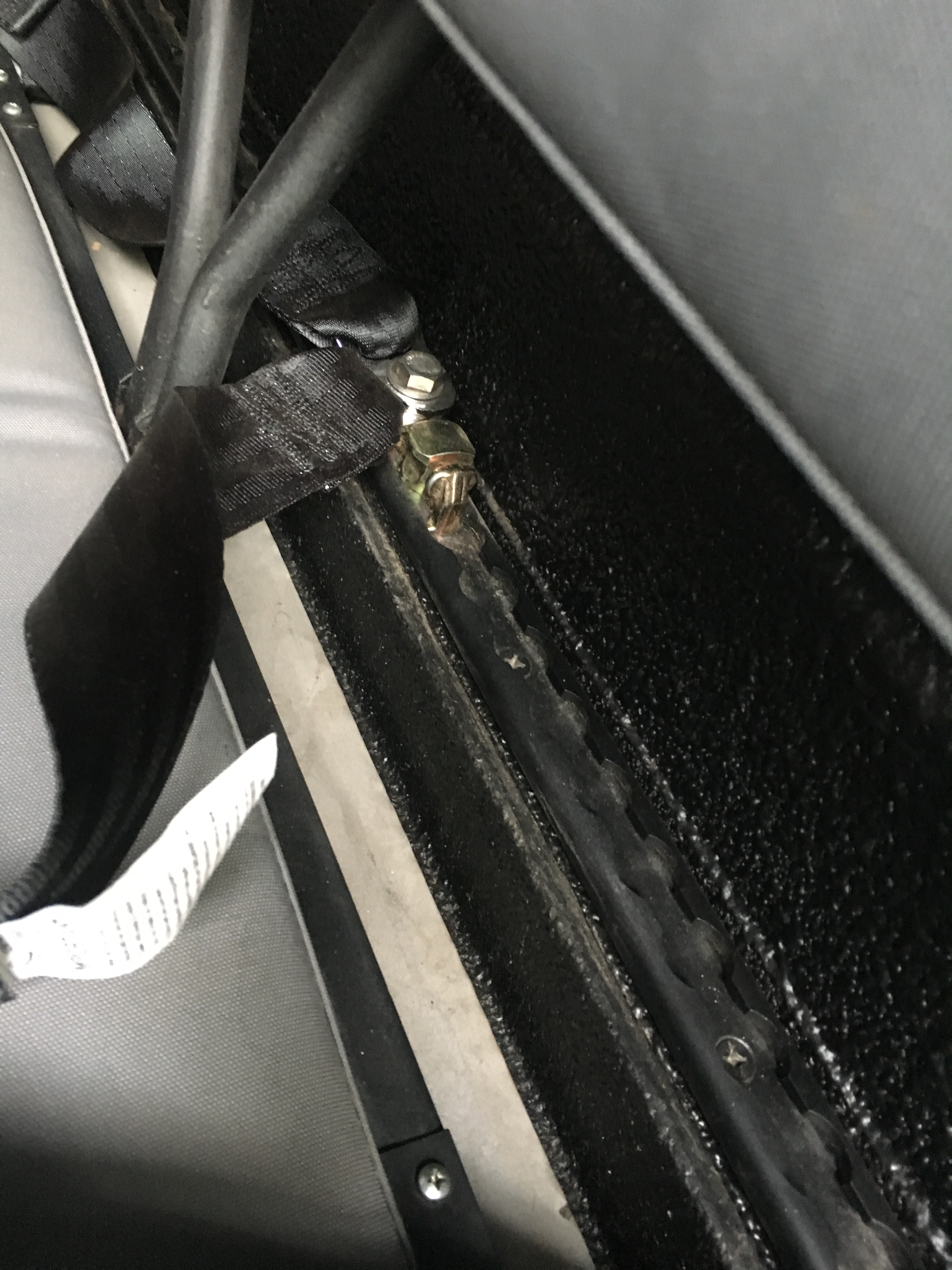

Standard use is obviously for seat belts.
The way I designed it also allows me to remove the side boards to create a flat bed pickup and still be able to reinstall the L-Track for tie down points.

How did you anchor the L tracks? Was it bolted through before you attached the side panels or attach somehow afterwards?
Thanks!
75 Swiss 710K
W9YG
Re: Where would one find an etrack rail?
whitesik wrote:Techmogogy,
Thanks!
They are bolted through ie to remove the side boards you would need to remove the L-Track.

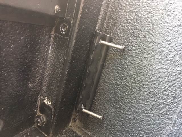

Here you can see how they are screwed down
Here it is removed (small pass side rear section)
Nutsert and sideboard hole large enough to account for raised lip
