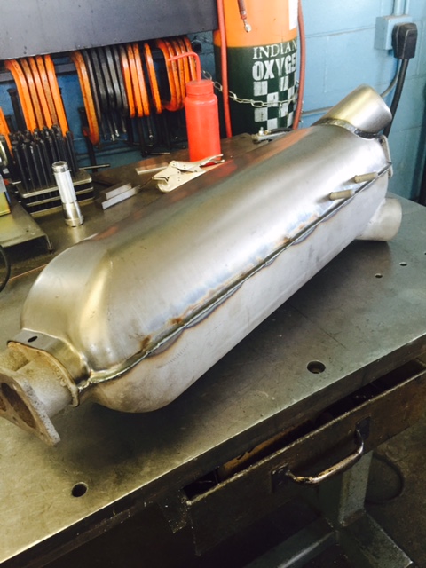

I am going outside my expertise a bit but I have had one of those exchangers torn apart. Perhaps if you could find a pipe whose OD is close to the old ID, one could weld that to the relatively beefy flange then insert into the old pipe to clamp. Actually you could take the pipe all the way to the front flange. that would ensure no leaks elsewhere for exhaust fumes to enter the cabin ventilation.

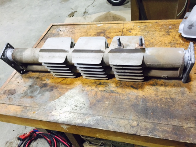

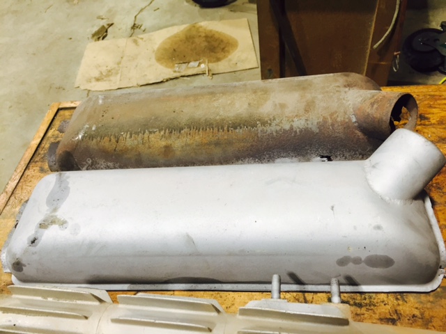

Yes, I took it apart because of significant rust on one side. Although I could not find a good or new exchanger then, I was able to find the half shell that I needed. I cut it apart, cleaned and media blasted it and a friend help to weld the shell back on. The internal fins are cast aluminum around the pipes.

Well that makes it a lot more feasible to repair as a lot more pipe is exposed to work with.
But that's some welding skills I don't have :wink: so I'd be apt to just get a decent replacement.

I have a set of the pipes from inside a heat exchanger with the flanges welded on and in good condition. The shell had rusted out and the aluminum fins were bad so were removed. I made a temorary bracket to help support the pipes from the original heat exchanger mount above.
I'd be willing to sell it if this would help you out.
