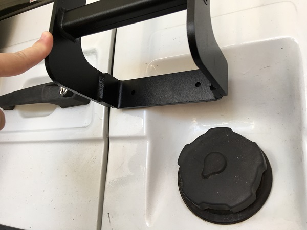

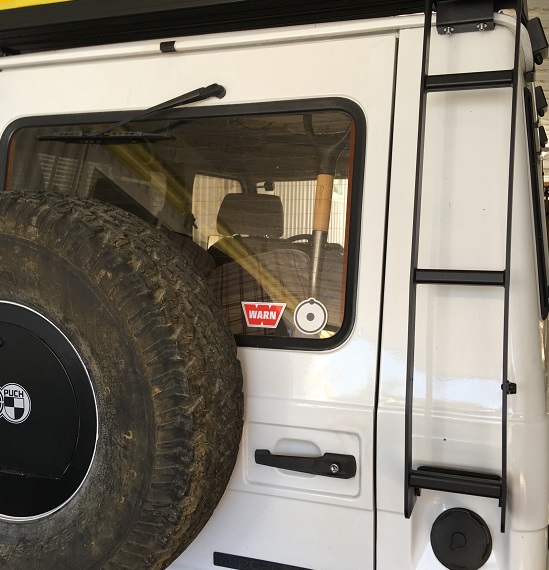

The ladder was a fairly simple mod.. This is an aluminum ladder made by Frontrunner for G-class trucks but they don't fit the older ones like mine on the psng side due to the fuel filler. When I looked at a demo version of it initially it seemed too lightweight to be functional but after putting 200lbs on it, and seeing that it didnt even flex, I waited to get a deal on one. (It has a stainless steel mount that supports all the weight when climbing it.) If I were using a ladder really often I'd have a FatFab one built but this one works well for what I'm doing with it, and it feels like it must weigh 5 lbs. total! We moved it over and cut the bracket off to match the slope to the fuel filler. It's well out of the way of everything now. Very happy with it.
Before and after.
Before and after.
