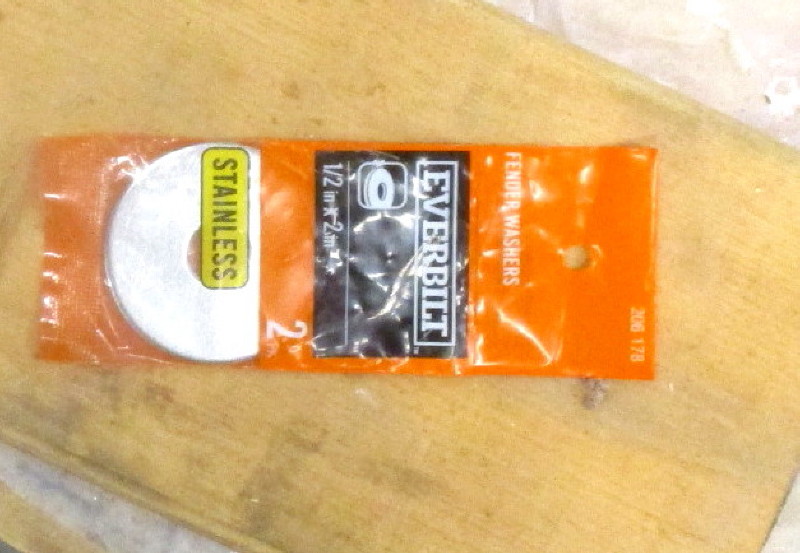

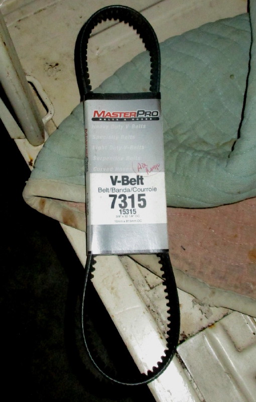

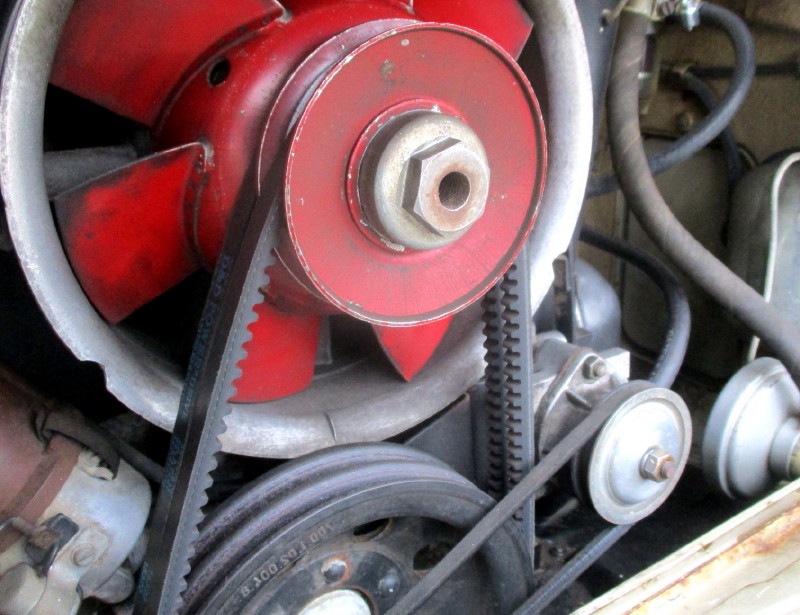

Both the original sized belts from ebay and the auto shop substitutes (photo shows the part number) fit well and were identical on the engine. With both of these options, I found that the belts were just a bit too tight, which meant I needed to add some pulley spacers (those larger thin washers) between the pulley halves to lessen the tension to the correct amount. Not really sure where I might find these washers as there were no spares under the main large retaining nut, which is where I thought they should be stored.
The orange package shown from Home Depot (stainless fender washers) were a match on the O.D. I had to enlarge the I.D. of the SS washers (using a dremel cut-off tool) and they worked perfectly, one per pulley. Now the belt tension is just right, no slippage, and by the time you get the key to the full CW position the engine has started. Sweet. Photo shows new dyna-starter belts installed (now need to find a spare one for that max rpm governer).
So - - you may want to hang on to that USA belt part number and grab a couple, as well as make a few washers when you have the time.

I had good success with my new belts and have some info to share:

Hi
There should always be 6 spacers on the dynastart of every haflinger, thats how they left the factory
