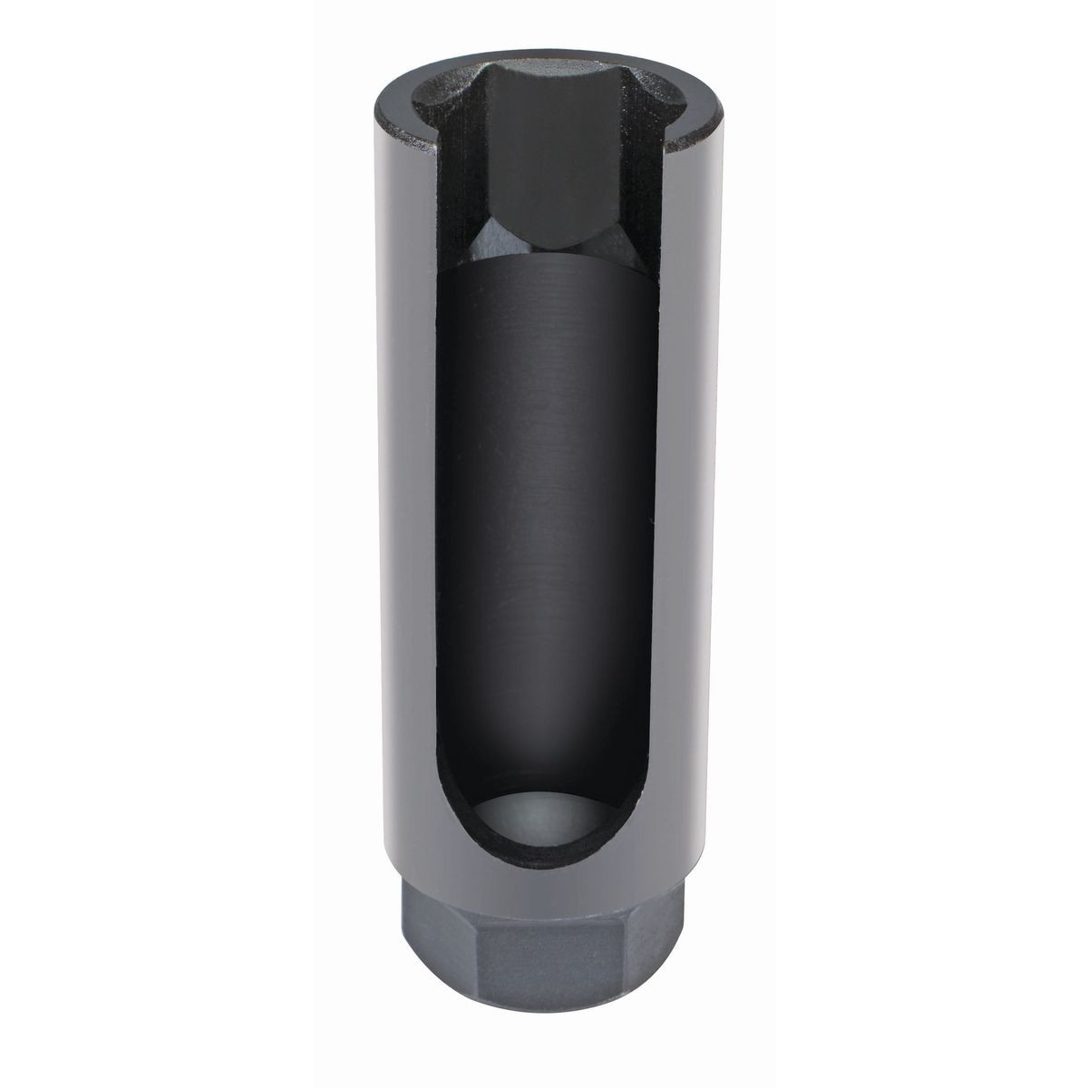

Has anyone come across a good tool for removing the spark plug wire retention 19mm nuts on the spark plugs?
The right size crow's foot wrench may work, but things are pretty tight (very few degrees of swing) in between the valve covers. They make special sockets for oxygen sensors that have slots on the sides -- that's the kind of thing I'm looking for. Or even better, something like the tool used for lawn sprinkler insert removal.
Yes, of course I could fabricate a tool, but I first want to see if there's one off-the-shelf. I've looked quite a bit, and not found anything.
I was able to remove mine, but just barely by using a collection of different wrenches that had slightly different angles. And even then, the plugs came loose before the wire-to-plug nut did, so that added a few complications. I'm simply looking for a better solution, and an excuse to buy a new tool. :)

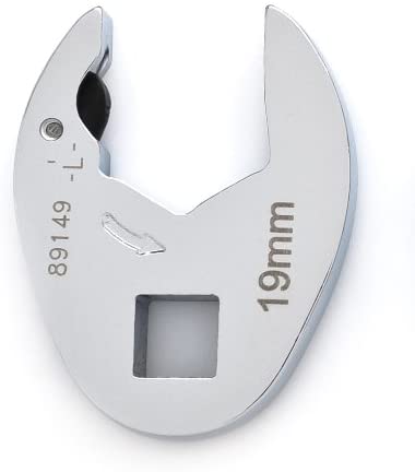

Perhaps this would do what you want?
https://www.amazon.com/GearWrench-89149 ... 059&sr=8-8
ChickenPinz
Posts: 440
Re: Spark plug wire tool?
Post by ChickenPinz »
Yes, that's the crow's foot wrench I mentioned, but it has the size limitations I pointed out.
I'm expecting someone makes something more like the specialty sockets like used for O2 sensors, but I've not found it for 19mm.

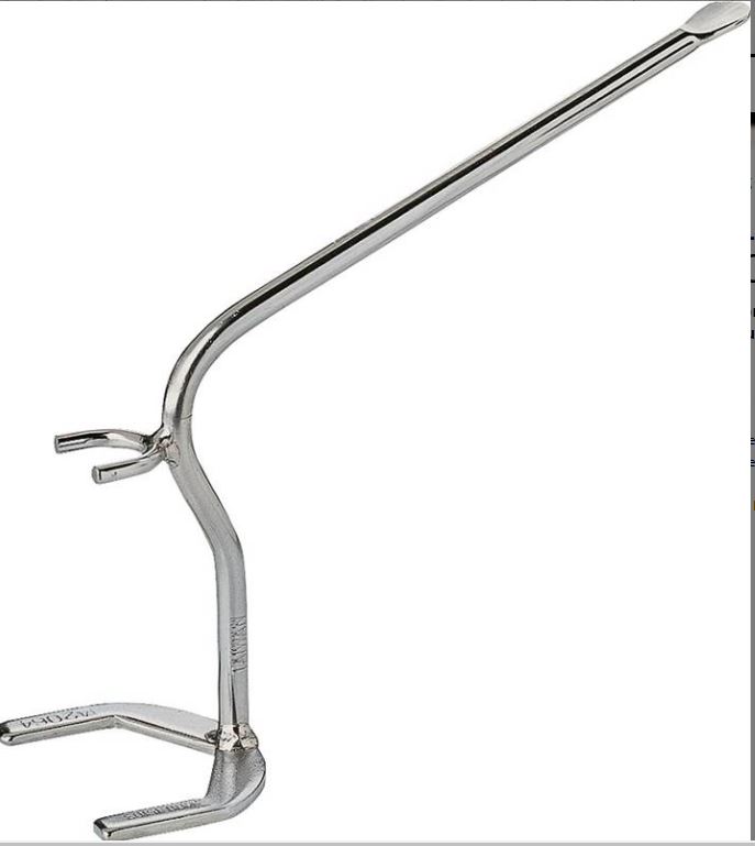

I think the best tool is that mil right angle thing modified to be the same shape, only 3 inches shorter.
