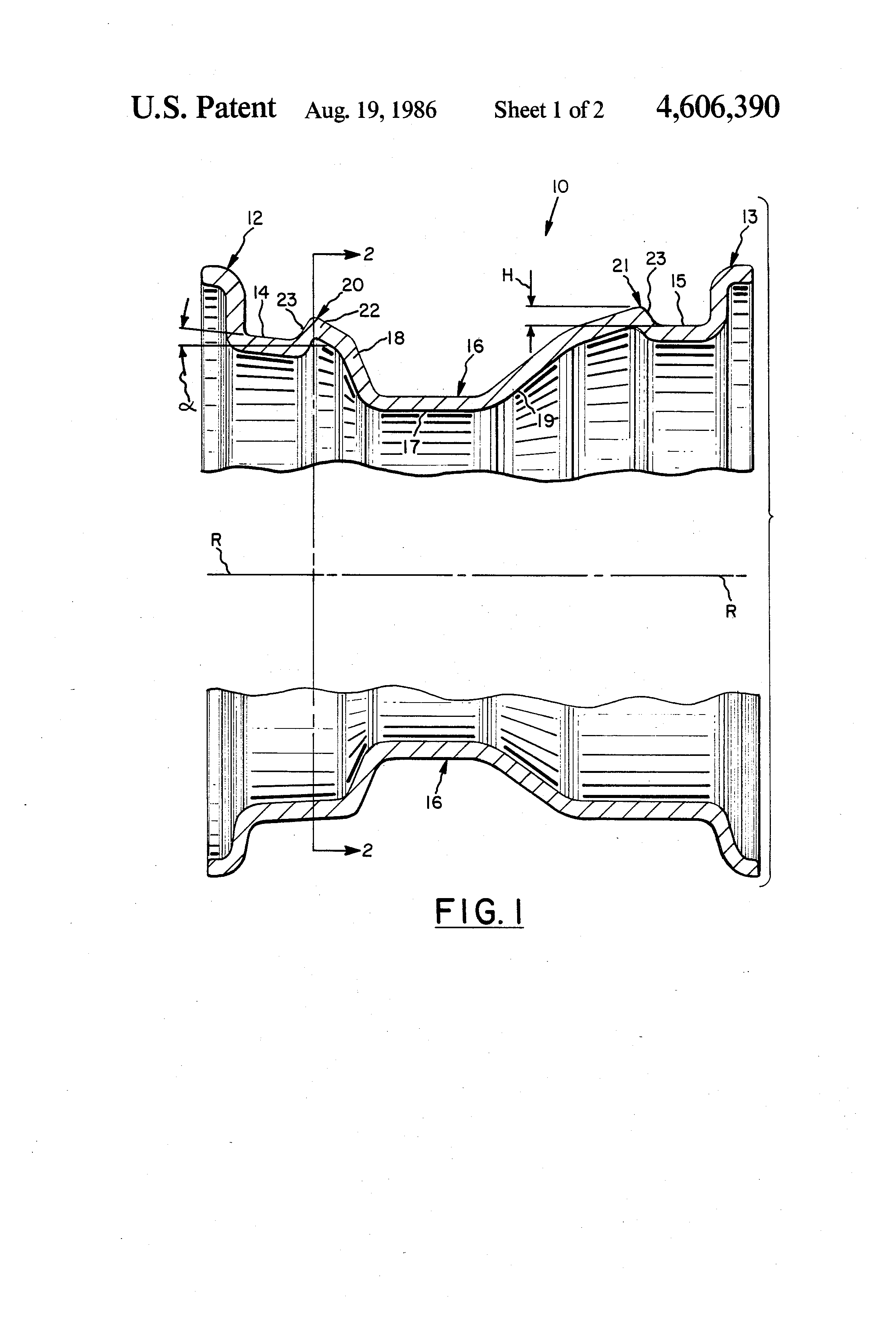

LT255/85R16 tires can be mounted on the stock wheels (rims). Note that the rim design does not have the bead retaining ridge.
They are like the bottom profile (pictured below), whereas most modern rims are of the upper profile.
