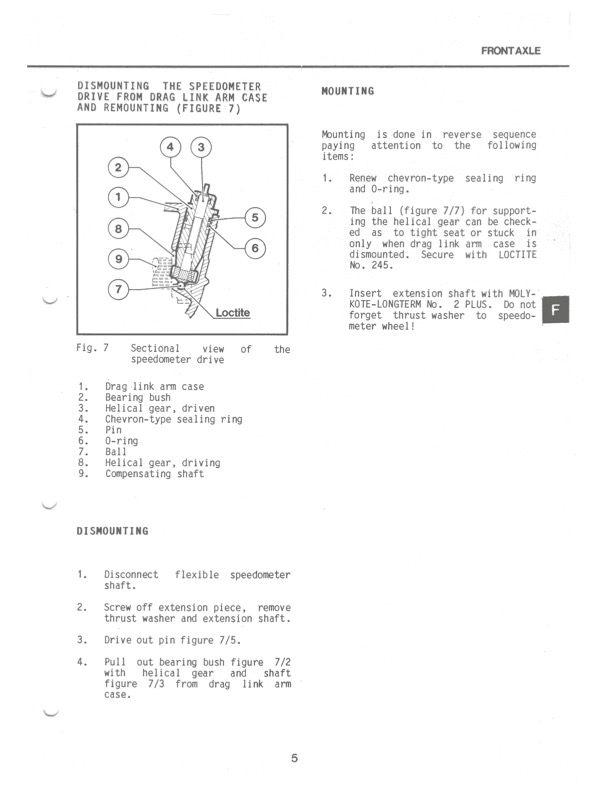

Hi there,
Happy New Year for all fellow Pinzgauer drivers, wishing you all many safe kilometers or miles in 2023 !
I have a leak at the speedometer linkage and have new washers and seals for it.
I can detach the cable by screwing off the ribbed cap but cannot get the next part off.
When i turn anti clockwise with a 22mm spanner I can only turn half a turn and then it blocks...
Any ideas or suggestions ?
Thanks.

From the Pinz 710/712 handbook,
sorry it's in french but the steps are few only
on step 3, they say to remove a pin (part 5 on drawing)
that appears the only stpe blocking you from removing the gear
hope this helps,

Re: Speedometer linkage leak
Post by Stumbler »
Super easy fix. In English. If you haven't already done this and finished the repair ... Just disconnect the speedo gear. Note: there's a little pin that you push through to disconnect it. Carefully, very carefully, pull the cable off. There's a little connector and if you drop it inside, you will have a whole other problem. Then slide out the speedo gear shaft. About 3/4 the way down the shaft is an o-ring. Replace that o-ring and your leaks should go away. When replacing the shaft, be careful not to drop anything in the hole.
