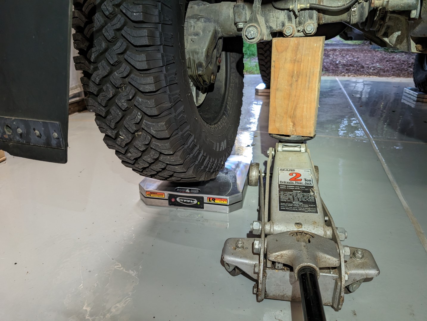

Since no one had this data to share, I went off and borrowed some racing scales to collect data. Here's what I learned:
All numbers are with the truck fully-fueled. Additionally, the truck has the standard tool kit, and a ham radio setup with a 20Ah Lithium Iron Phosphate (LiFePO4) battery and stubby roof-mount NMO antenna.
- With chains and a few light tools and water bottles in rear is 4842lb, with a 52.9% front axle weight bias (test 7).
- Without gear in the back, it's 4747lb, with a 54.0% front axle weight bias (test 10). This is what I'd consider the practical trailering configuration given you'd want full fuel when you hit the trail.
- When a 210lb driver gets in, it adds 142lb LF, 68lb RF, 45lb LR, and -44lb RR (test
. Since you sit over the front axle, no weight is added to the rear, but since it drops the left side a bit, it lightens up the right-rear tire by about 20% of the driver's weight and shifts that to the left-rear. So 5052lb is my normal driving weight, with 54.8% front weight bias.
Using this information, one could calculate where to position the truck on a trailer to achieve the desired tongue weight.
If folks are interested, I also have left/right data as well.

Very interesting1 Share more data please. I know you are doing this for trailering but I think it also helpful in loading the rear for camping or considering the ideal place to put additional batteries. Thanks!
