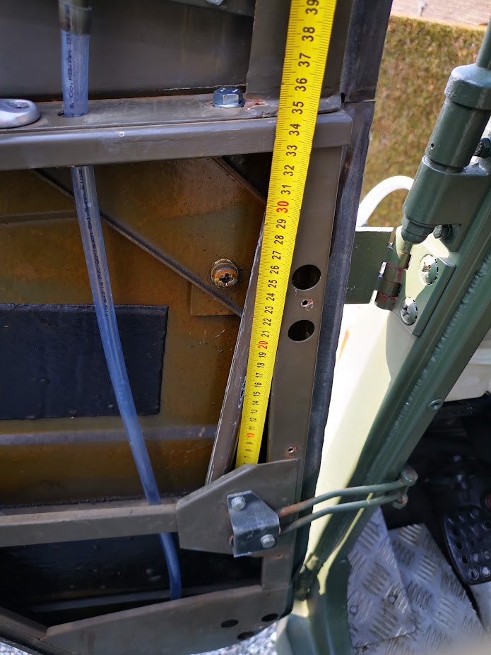

I saw those drains, yes. I'll have to replace one side of tubing as it is absent. Does that just shimmy to the bottom of the door through that mid-hole in the door? It doesn't sit on any bottom fitting does it? I see the exit hole but haven't separated the two halves of the door.

Mines were also missing
i just bought a piece of tube and passed it through the door,
it exits a few mm at the bottom, we can see the tube in this picture
Hugues
From Switzerland

Thanks for showing me that. I just got some new weather stripping for the windows so that will finish this portion of my truck that is in 500 pieces :D
