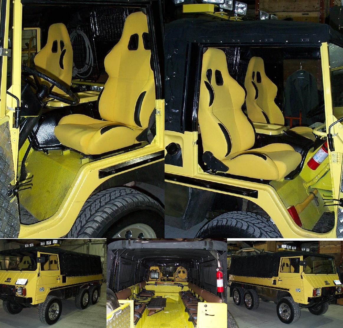

This is the seats at ColdWar
http://www.coldwarremarketing.com/image ... mseats.jpg
2012, You will learn that Pinzes are a lot different from any other truck , and "typical run of the mill" items will not work. Seats must be of a low cushion to allow for taller driver, thigh support cannot be too high that it hampers getting behind the wheel, and the the seat can be fasten that it will work with the original seat pan, or have a quick disconnect to get the doghouse off. Passenger seat must be narrower than most seats.

I went with Cold war's Recaro's in my K. I can tell you it's a no brainer to swap out the stock seats for the new ones. Patrick & the crew thought out this replacement very well to insure the mounting is the same as stock. They are a little heavier than stock as the mountings are stout steel tube construction. At 6' I can see out fine but they do raise you up a little over stock.
I tried messing with putting in some seats from another vehicle and the problem is the narrow area you have to work with surrounding the engine cover especially the passenger side.

These seats are as comfy as any modern seat & then some (Recaro having had a long aftermarket reputation). Adjustments include: for & aft slide, infinite back angle by dial, & complete back fold forward by way of one lever pull. And as mentioned undo one wingnut & remove/replace as stock
