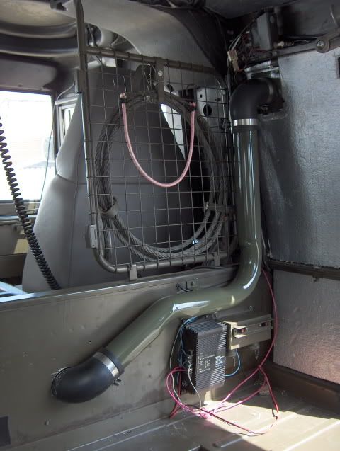

Thanks david I might copy if you don't mind, also do you have any close ups of your air intake I am working on one at the present. sorry to change the subject as I know Jim hates it but I noticed your's

Erik Maybee wrote:Thanks david I might copy if you don't mind, also do you have any close ups of your air intake I am working on one at the present. sorry to change the subject as I know Jim hates it but I noticed your's
I also have a snorkel:

Erik, the raised air intake is the stock one for the 716, as are the rails.
