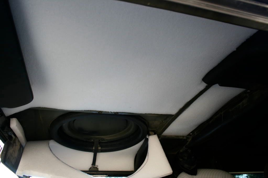

Well It's getting hot so I decided to insulate my top here is a few pic's. Image Image
Once done I will have it sprayed with LineX

Is that closed cell foam? The biggest thing I did with my top is to paint it white! After that I found I really didn't need any insulation.

Yes,. I plan on painting it white. How did you get rid of the condinsation? I don't remeber any insulation on your roof?

I used half inch closed cell foam from home depot or lowes. It has a silver side. It is fairly rigid. Works well but you definitely need the right adhesive, especially if you put it up before you paint the top white!
I will see if I can find what adhesive I used. There is one type of 3M that won't work.

btw: re white paint - there are differences. some reflect ir really well (designed that way) and other dont as well. it's worth seeking out the good stuff.

I used polyethylene foam. Came in 4' * 12' lengths and was and inch and a half thick. I am having a hard time finding the right adhesive to use.

So does adding in some insulated material (that's either already white or would be painted such) really help to make the cab and rear of a Pinz more comfortable? It sounds like a good idea and this seems like an easy to execute project but does it really do anything useful?

Makes a big diff here. My hard top got so hot last weekend my son burt his hand on it. It's been 102F sense sunday and rain for three days before that.

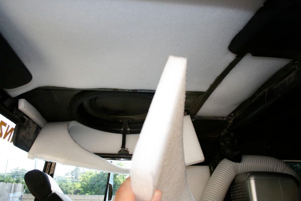

Put eight hundred miles on the pinz over the weekend. Was hot to say the least so hot the insulation wanted to pull away from the body so I removed it in areas. Ideas on what glue to use? Image
