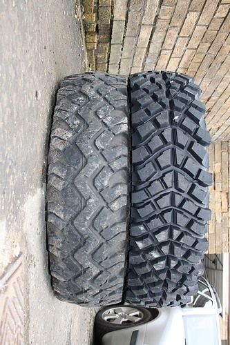

Greenway 235/85R16 MACHO (not produced any more) shown here next to the Mayola's.
