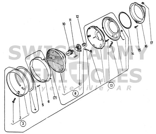

So if I understand this correctly, I can take my bulbs out of my 7" round fixtures and install h4 bulbs? If so then I could upgrade my headlights with a 24v h4 HID correct?

Re: PLUG 3- WAY headlights
The electrical connector will fit both the standard (A base?) and the H4 bulbs - but the stock bulb holder only works with the old bulbs. I've seen people try and make it work but its not worth it - just get a new set. Be sure the new ones have the side bulb hole for the "city" lights if you want to keep them.
The electrical connector is available at all auto parts stores.
