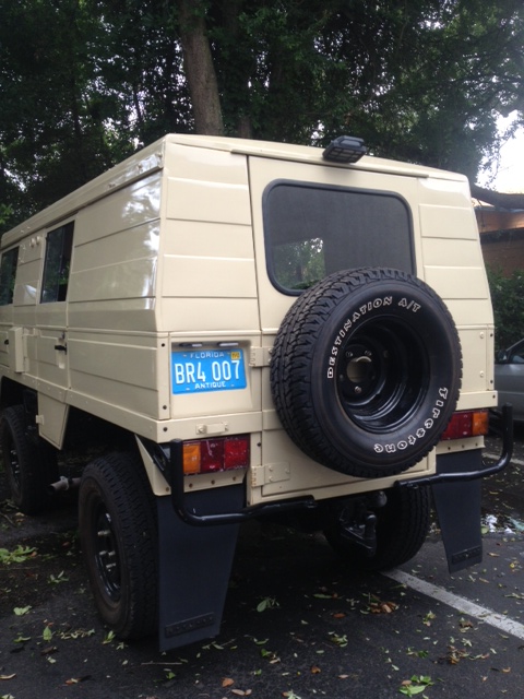

Yes, it's all fixed now
I got the truck a few months ago off Ebay for $8900
- photo.JPG (146.44 KiB) Viewed 6291 times

Re: Shifter ???'s
Yup nice purchase and I remember the massive speaker boxes by front seats
