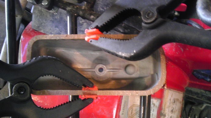

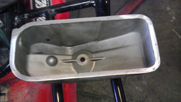

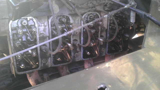

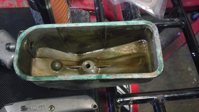

Yes, I should have separated the posts. I just thought it would be more practical to write a post about both of my problems. The Rancho RS5000 I have seen where from http://www.pinzgauer.com . I just finished changing the valve cover gaskets. It took me about 3 hours. I dont know if thats normal or I just wondered too much cleaning stuff and looking around. I have a couple of pictures I took with my phone, nothing great but it will show you what I did. I dont really have much mechanical experience but this was pretty simple to do. One of the best experiences with vehicles I had in my 24 years. Working on this Pinzgauer made me learn a lot, and I am glad I didnt take it to a mechanic to do all the work.

Post by OHAM1 »
Some more pictures along the way.
