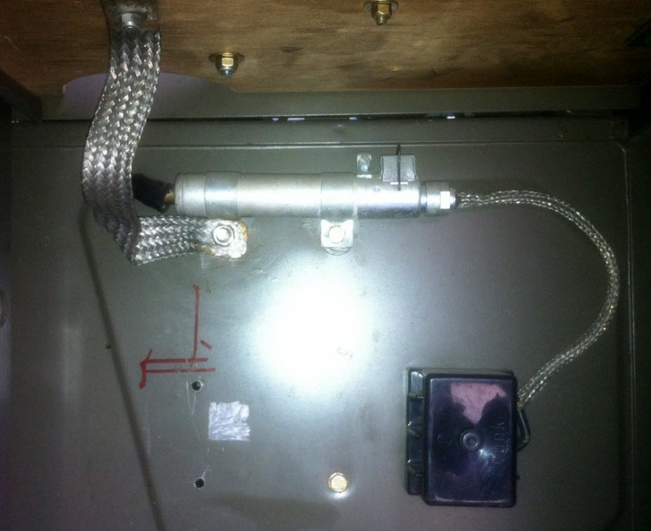

Also this one under the right side of the desk.
Any light that can be shed would be appreciated.

Niether connection apppears to be Pinz Original. The one on the passenger side looks to make use of the bolt holes (4 ea) originally used to mount the twin power plugs originally used for the radio equipment in a K model. Does power originate from the engine compartment? My do. twin black leads.
The set up on the driver side is beyond me. Sorry. Seem like a previous owner made modifications.

To me it all looks extra heavy duty and rather military. Not something to my mind looks like any civilian install. I believe I am the only real stateside owner.
I have not traced all the wires back to their sources. The ground strap on the right goes from the radio table to the metal divider.

the one on the right side is a noise suppressor like mounted by the coil on the engine

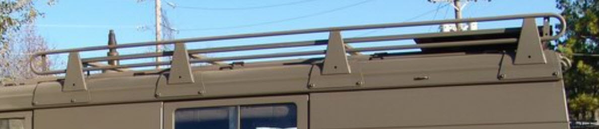

While probably guilty of thread creep in my own thread, one of the other 710K's I was looking at had an original military roof rack that I thought would have been a good add.crcpinz wrote:As far as the rooftop heat, it actually goes away magically if the vehicle is in motion, but I don't live in Texas. A roof rack as a second roof would help a lot in that sense.
Are these available anywhere? Might be a good start toward mitigating some of the heat.
