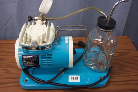

I don't know anything about either of those bleeders. I use a Schuco-Vac medical suction pump. It's a 110v pump with high power suction; I just hook the hose to the bleeder valve on the dif and keep it sucking while someone is adding fluid to the reservoir and I keep it going until the stuff coming out looks nice and clean. You can get these on ebay for about a hundred bucks, but I think it's worth it; I don't think any other bleeding method can really pull the old gunk out of the lines like this can.

Cool! Can the suction from that thing damage anything? Seals etc?
Re: Motive Power Bleeder
I would imagine not since it's just sucking fluid through from the reservoir which will have the cap off. If you were just sucking against an open bleeder valve with the cap on the reservoir, I don't know if it would damage anything or not, It's possible I guess, or it may just collapse it's own hose. I just don't see a reason for it to damage anything as long as you are just sucking fluid through... in one end and out the other. If you have a clog in the line that's stuck so hard that the pump damages the system, I suppose the system was screwed anyway. All I really know for sure is that my hydraulics were in bad shape and my lockers were not engaging, so this was what I did and now I have no hydraulic troubles at all. I did the brakes this way too.

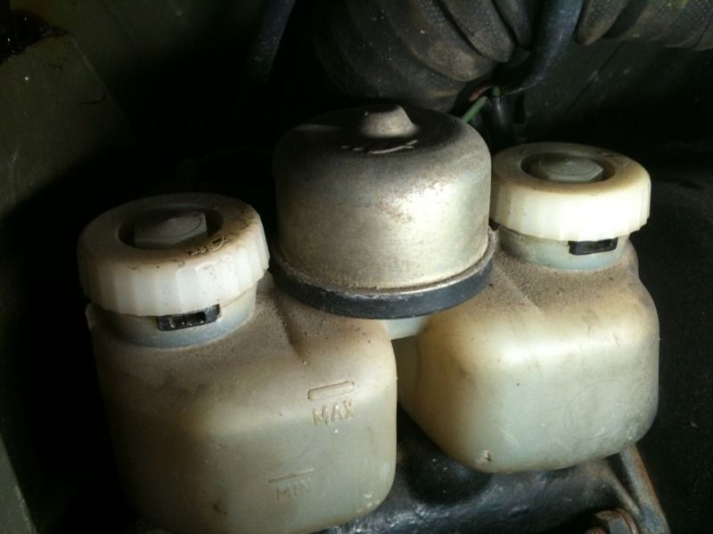

One thing. The dual brake reservoirs ...DO NOT TAKE OFF THE WHITE OUTSIDE CAPS. Only take off the center metal cap. It is the same size as the
locker and clutch cap. If you take off the outside caps you are in for a world of trouble...Of course you can ask how I know!!!!

Thanks for that! I never realized the centre cap, well, was a cap....It just unscrews?? (Stupid question, I know...) Any special method to bleed being a two reservoir?
Check with your maintenance manual. My understanding is that there are two because one is a backup.
Once the centre cap is off the bleeding is done just like everything else. Make sure there is plenty of fluid
in the bleeder so there is no need to keep checking the fluid levels in the reservoir. Getting air in the lines
sort of defeats the reason for the job.
Since you are bleeding the lines, might be a good idea to suck out all the fluid in the two tanks so that the
crud in the bottom of them isn't going down the lines. I did that on the lockers and it was amazing how much
debris was in there, almost black liquid. Hard to see in them as the plastic gets old, dusty and discolors.
That is going to be a PITA on the reservoirs so a small flex line might help. With a turkey baster.
I did it right from the top as I had removed the white caps first. So very wrong thing to do. The little 'O' rings are
a real pain to get back in.
