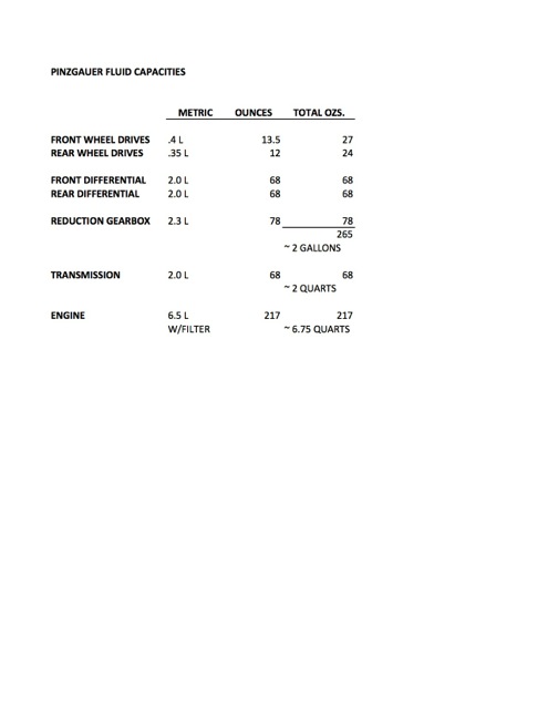

Hi All, I have just purchased a 1979 710M that needs some work doing on it, mechanically great but the body is showing its age. Can anyone help with the volumes of oil required for engine, gearboxes and hubs? Also, is there anything to watch out for whilst servicing the engine/axles/boxes. Thanks for your help!

Do you have any of the manuals? If not, I can help you there. Someone got them for me, and I would like to return the favour.
edzz wrote: Chevron Delo® Gear Lubricants ESI 85W-140
Oil Capacities
spec- SAE 90 MIL-L-2105
Reduction Gearbox 2.30 liters
Diffs 2.00 l
Front Hubs 0.40 l
Transmission 2.30 l
Rear Hubs 0.35 l
Steering 0.45 l
spec- SAE 30 or 15W/50 or 20w/50
Engine 7.0 liters 6.5 liters @ OIL CHANGE
DOT-3 SAE-J-1703
BRAKES 4X4 500cc
CLUTCH 200cc
GEARSHIFT 400cc
Posts: 1639
Re: Pinz 710 fluid volumes and so on
Here you go:
Pinz Fluid Capacities.jpg (22.69 KiB) Viewed 2066 times
