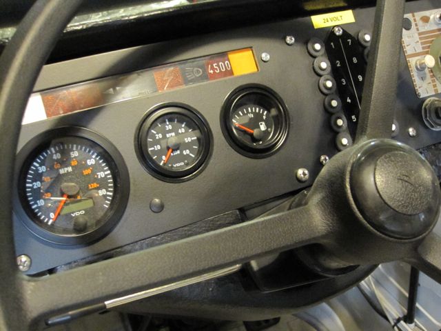

2) Speedo: from what I read a lot of people have upgraded to VDO units that fit the existing dash position without too much trouble. Although they are not forum supporters like Scott at EI, Swissarmyvehicles.com have them on inventory.
I haven't taken the dash assembly from my truck in quite some time, but I seem to remember the dash screws to be quarter-turn or half turn and off, so it should be easier than with regular screws.

I had one of the VDO speedos and they are a fit for the original SAV part no VDO4372
1/4 turn fasteners for the plate in the dash. Easy install, comes with new cable, may have to adjust if your wheels are larger than stock.

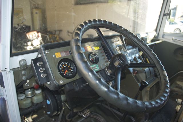

1. See here: viewtopic.php?f=18&t=5326&hilit=Model+265
Scroll 1/2 way down to see front and rear LED side marker lights - 12v run in series - very clean and neat IMO
2. VDO is the way to go
Sample install pic (not my truck)
Welcome to the board!
- VDO.jpg (47.69 KiB) Viewed 8804 times

X2 on the VDO speedometer.
Here's the unit complete with the needed sender: http://www.pinzgauer.com/showdetails.ph ... no=SAV1406
Re: Street legal: front marker lights & replacement speedom
Put them in both of mine. Only complaint is that after three years the speedo stopped reading in the 710 but the odometer works and in the 712 the odometer only displays about 10% of the time. Have checked and rechecked electrical connections and wire routing to ensure no damage and all appears normal. We have had a couple completely fail but that was after five or more years in service.
They are really a great alternative to the original. At least when they work they are FAR more accurate then the original ever was since you can adjust them for the tire size you are running.

Nice to here about another Pinz owner on the Island. I have the VDO speedo conversion, it was a pretty straight forward swap by following the instructions and I can help you if you want to meet up (pm me for contact info).
