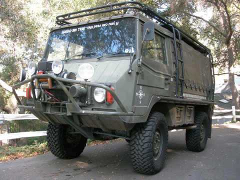

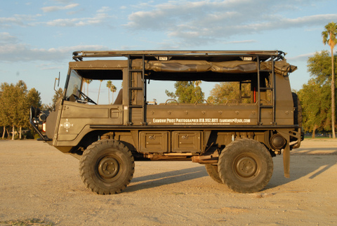

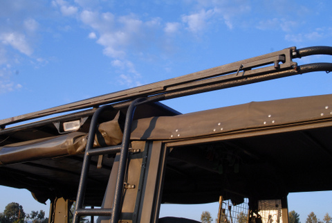

Not sure but these pics may help that I had saved to my computer a while back?
- 7809314240_ac7b6ebdd8_k.jpg (78.57 KiB) Viewed 3479 times
- 7809332302_6ad6364b8e_k.jpg (106.31 KiB) Viewed 3479 times
- 7809945278_f6038ac659_k.jpg (147.06 KiB) Viewed 3479 times
