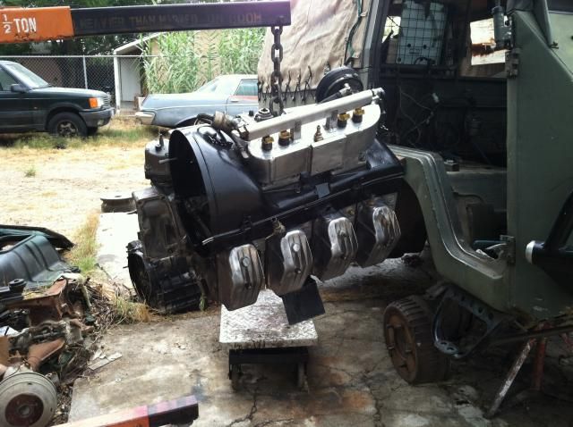

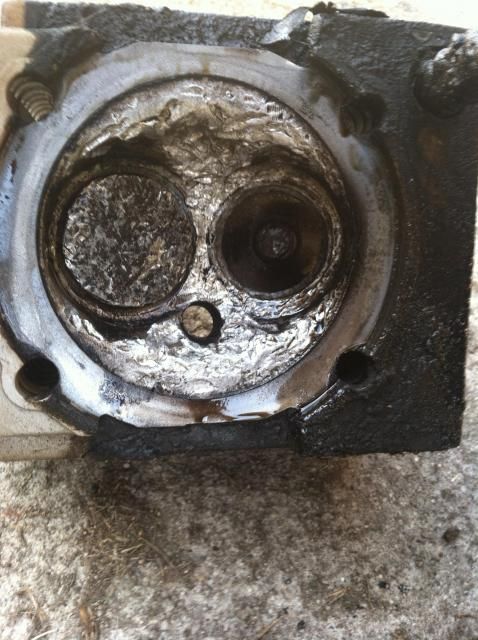

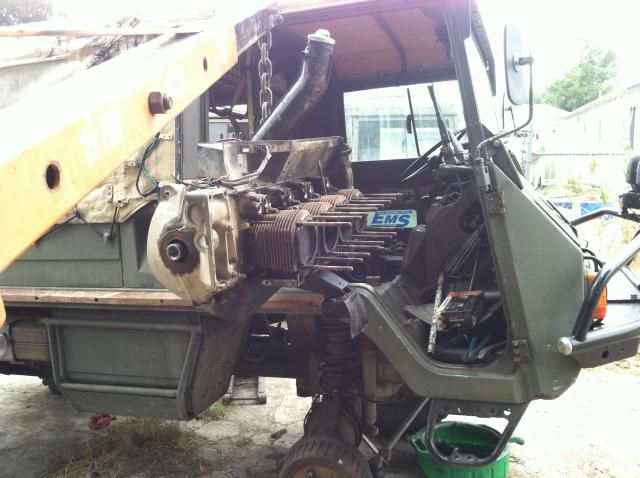

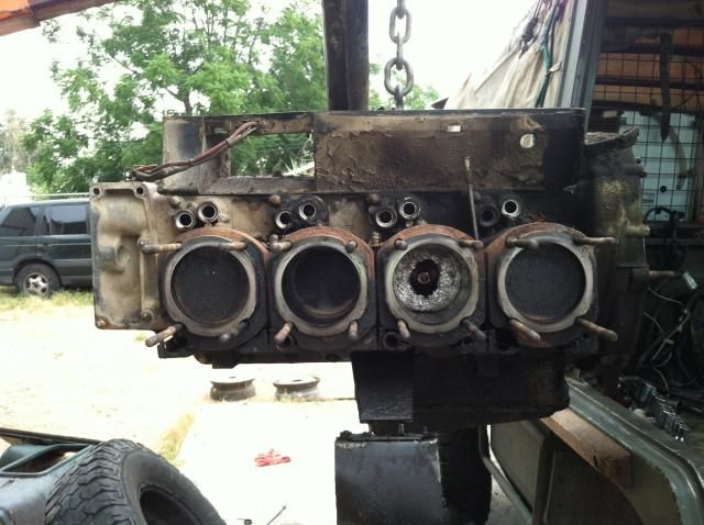

Back on the road :roll: Dan, I cheated, most of my engine has been built sitting on the stand for a very long time :twisted: .
I am back onto yours now. Your Motor may be running sooner than you think :P . Finishing suspension work and door glass today.
For now here are some pics of my mess.
Cheers, Jim LaGuardia

Ok now that that is cleared up......... WOW that damage is NUTS!

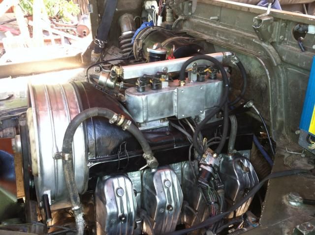

New cam working good, pulls nice on acell. Still have some re tuning to do, but already made good base adjustments.
Now back to the prime directive :mrgreen:
