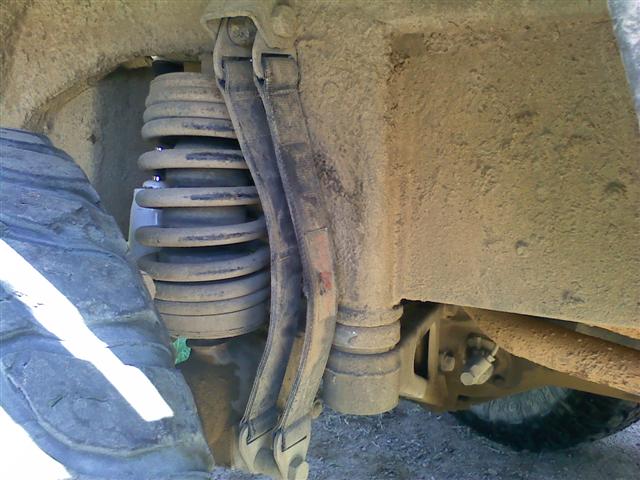

Re: Length of OEM limit straps?
Here is a pic of the limit straps installed, yes they are dirty I do use my truck once in a while :wink:
0728131515 (Small).jpg (60.07 KiB) Viewed 8899 times
Have had these straps on for a few years now. Mark's old 712 has had them on at least a year longer then mine and while his truck did not see as much trail time the straps look great. the tires (285 16 75r on widened rims) rub them when at full suspension compression and making hard turns. The reason I chose to run two was in the event one broke I would still have time to get it replaced without concern for suspension damage. When the single originals would fail I would take the truck off the trail to prevent any damage to the running gear.
the ones I have on my 712 (in photo) are from SDHQ but they are similar to the ones available at most quality offroad centers. All the rock buggies use them to limit their travel.
I used 3/4 black pipe, being a plumber has its advantages, cut to length to fit between the two straps. I used the original bolts. The strap brackets are only about 1/4' and the original straps are about 1 1/2 inch so the difference had to be made up.
