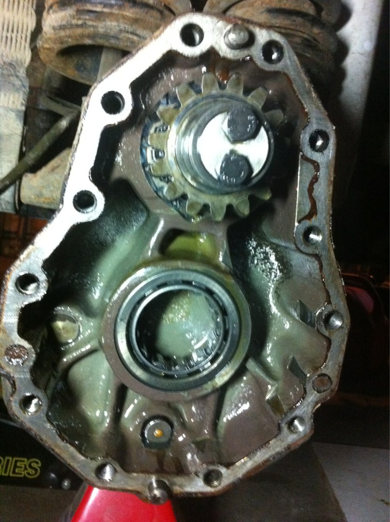

Today I decided to tear into the PS rear as this is where I think the noise is coming from. I took apart the shoes and removed the entire hub. This wasn't the daunting task I anticipated. I feared for the lose bolt, but it doesn't look like anything is loose in there. Do I have the newer setup Undy was referring too?

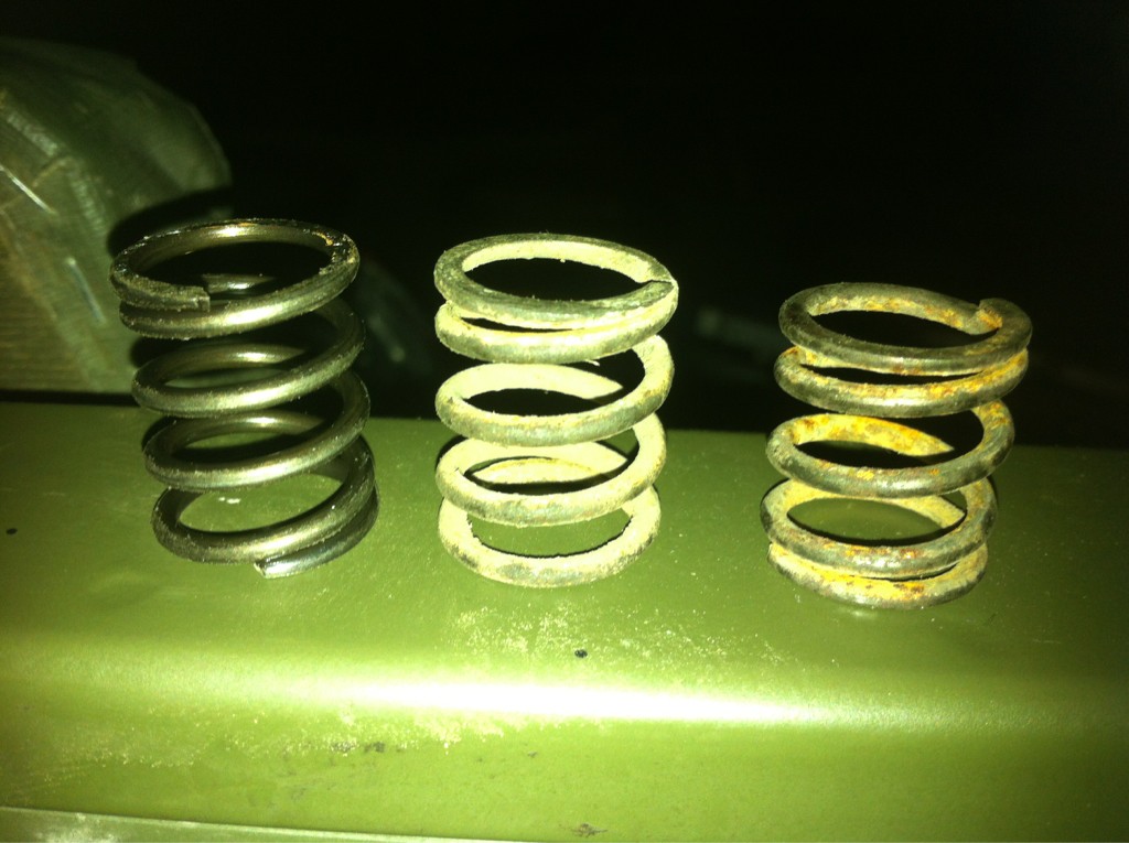

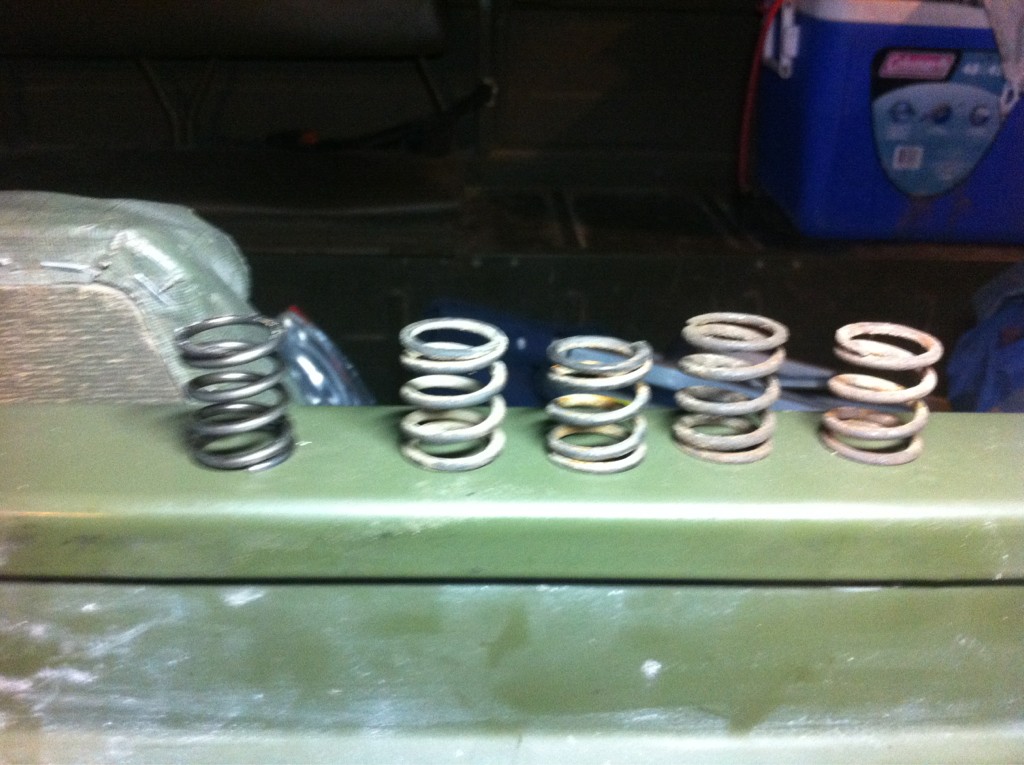

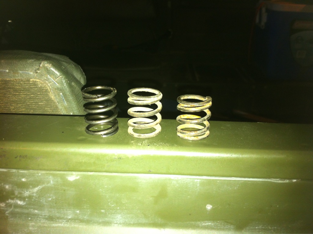

One thing I did notice and what I still think it may be, are the retainer springs. I bought four from SAV and did a comparison.
Can you guess which of the springs was on the rear most shoe on the passenger side?
New spring on the left, next pair from PS and last pair from DS.
My suspicion is that there was not enough tension allowing the shoe to move in the drum. Reversing seemed to aggravate it.
Does everything else look okay to you guys?
I noticed this on the back plate, but is outside of the sealed housing.
