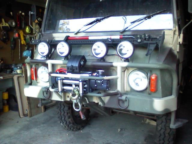

Re: 50" LED light bars.. looking for some input
this works well.
- 1007131741.jpg (76.38 KiB) Viewed 7414 times
