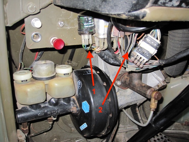

Not sure if you have an Austrian or a Swiss Pinz but on the Swiss schematic I only know of 2 uses of the black/yellow striped wire:
- (1) one connects 49A on the turn signal flasher unit to 49A on the hazard switch, both to the left of the steering column
- (2) the other is a lead from the turn signal switch that connects to a black/white striped wire in the Pinz harness and connects to the rear lights. This is also just to the left of the steering column.
