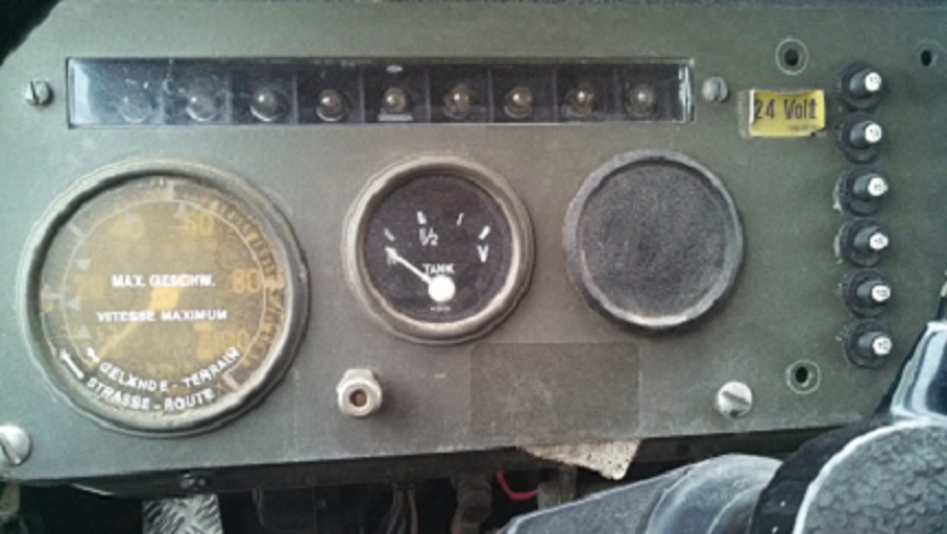

I'm currently looking at a 710m to purchase but the row of lights on the top of the instrument panel are non existent. It does not have the 9 square colored lights just a a clear piece of plastic and the bulbs underneath. Since this is the only pinzgauer I have ever seen in person I assume its missing a plastic insert, I have emailed numerous parts outlets and the only response was from swiss arm vehicles which said they have a few of the colors but didn't specify if they stick on or what. If anyone can lead me in the right direction it would be greatly appreciated. I've attached a picture to better explain.

The indicator strip is made up of 2 sections that can be separated after removed from the dash. The lower half contains all the sockets and bulbs. The upper half is clear and normally holds the colored plastic squares that the bulbs illuminate. Usually you find that the strips are intact but all the colored squares are faded from age. Someone has removed the squares from the one you're looking at. Replacement indicator strips are almost impossible to find and very pricey. SAV does carry 2 or 3 of the squares.

Another option would be to make the graphics on a computer (I'd do it as a single strip, rather than individual squares)
Print it out on some onion skin paper and insert it the same way as the originals do.
You might have to do a little trial & error to get the right dimensions.
edit: Looks like the circuit breakers have been changed out at some point. Hard to tell in the pic, but looks like 10amp (stock is 8amp)
and is missing the number ID plate. I'd take a real good look behind that panel to make sure the wiring job is up to snuff.

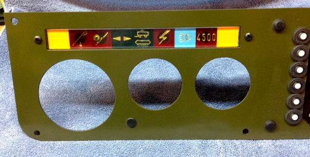

Here you go - a brand new strip:

Thank you Pcolette, did you buy that set up, dash and lights? or is that a re-painted dash?
Re: instrument panel lights
It's a soda blasted and repainted panel. The strip was bought new a while back. I also added new switches and circuit breakers and hope to install it in the next month.

Pinzi73 wrote:We're did you find the light strip?
A friend in Europe found it for me. I tried to get more but he was only able to get one. I don't know who he got it from but it was actually less $$ than one I bought a few years ago in the US.
