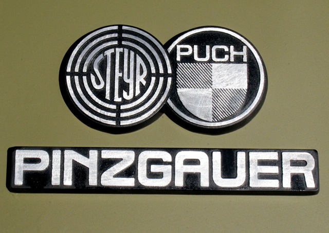

I am looking to restore or at least beautify the Steyr Puch insignia on my truck. I have seen a number of before and after photos, but no "How-To" posts. I was just going to polish mine, but some of the painted ones look nice.
I presume they never came painted on Pinzs or Hafis.. Only bright or OD overpainted.

I removed mine and boiled off all the old paint. Get a cheap pot at the thrift store...do not use your wife's good pan. Used TSP, it removes the paint.
Cleaned it up with a brass wire brush. Painted it black then used fine grit paper on a smooth surface to remove the paint at the letters and then clear coated it.
It is a bear to get off the vehicle as the tiny nuts are way up under the dash at the center console.
I lived near the ocean and the aluminum corrodes easily, giving a dusty look to the finish if not protected.

I did mine the same as Morris (krick3tt) and used emery paper stapled to a wood block to remove the black paint from the raised areas.
Like he said you'll need small hands and/or lots of patience to get the retaining nuts off.Paul C.

I wasn't sure if the Steyr Puch logo came plain, or if some models actually had the black-white-green paint.
I like the polished with the black paint in the recesses.

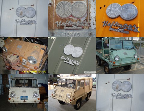

I like the black and polished as well but the Pathfinders came just bare metal (99% sure of that from all pictures I have seen and both my Pathfinders were like that - being 40+ years old I guess it could have worn or been changed?!?)cascade.king wrote:.. which you know I do.TechMOGogy wrote:Powder coating is great unless you have a NA Pathfinder model which were not OD

I just looked through all the NA Pathfinders that I have pictures of and all but 1 have a bare logo.
The paint may have worn off but I would be surprised if all of it had disappeared on 7 different trucks (8 if you include your truck
) - even the one at the museum is bare. The one with paint is Scott's:
I did notice that the Canadian and pre Pathfinder models (white turn signals) seem to be painted?:
Anyways - all are cool - post what you end up doing and you can make the how-to (then I can copy you!)

There are actually two versions of the Steyr-Puch logo plate - the earlier one that was painted with the green and white area in the puch section has a recessed area for the paint to flow in - the later version is flat in that area. I actually have one of each and had the earlier one cleaned up and polished by a local guy who does mostly motorcycle parts. He did a great job. I'll take a photo and will post it here later when I get a chance.
I also ordered one of the reproduction "Haflinger" badges with the handwritten script - I like it more than the newer rectangular one that is similar to the pinzgauer badge. The repo one is really nice - maybe nicer than the original (broken) one I have. The only issue is that the mounting holes are different between the script one and the rectangular one.

I know this thread was around for a while, but I thought I'd add to it.
I just finished cleaning up the logos for my 710M. I wanted them to
look a little weathered, but not all gooey and gross like they were.
Here's a quick pictorial view of my process. I used a flat engine
paint so they don't look shiny, and I added green to the shield so
it's more like the original.
I used the same techniques as previously described, with a green color twist.
The final product. Painted twice and sanded twice.

I stripped mine with Oven cleaner, then took it to the polishing wheel and made her shine line a piece of Jewlery. Afterwards I painted it with white black and green.
Once Painted I took a piece of deer leather with a little MEK on it and polished off the unwanted paint.
Total time from start to finsh was about 2.5 hrs.
