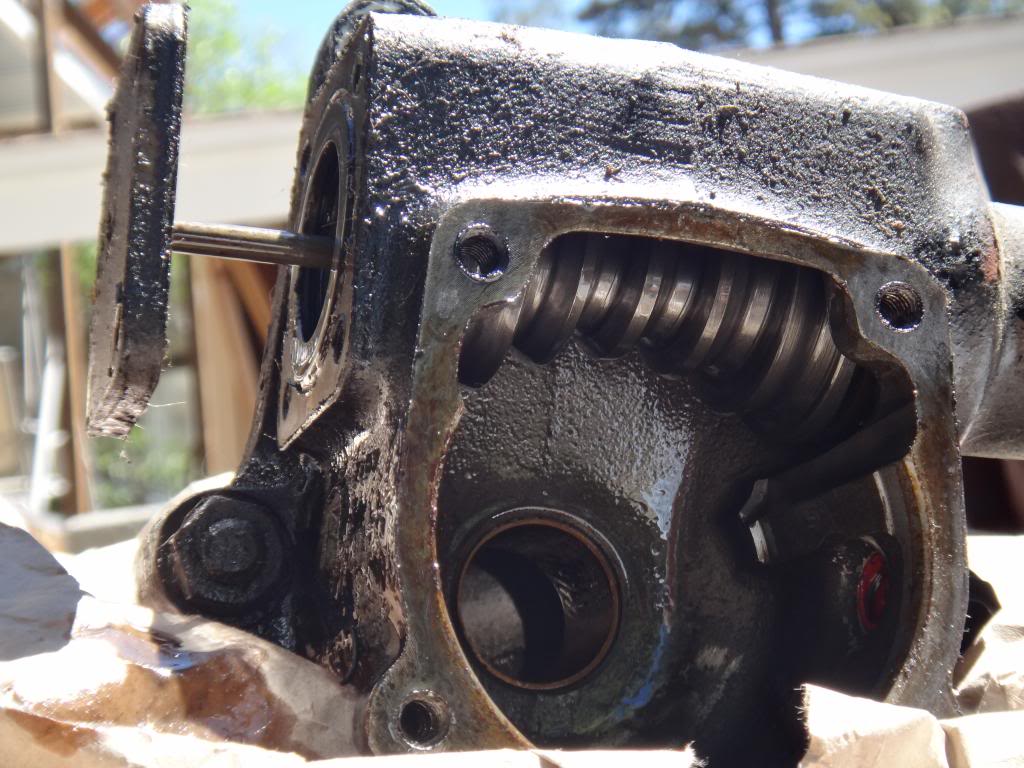

Now you can see how the mechanism works; a worm gear (cut to fit the arc of the pitman arm roller, narrow in the middle but larger in diameter at each end) pushes the pitman arm around. To prevent wear, instead of a sliding fit to the worm, the pitman arm has a roller so there is little wear from use. A gentle tap from a dead blow hammer drives the pitman arm shaft from the housing.

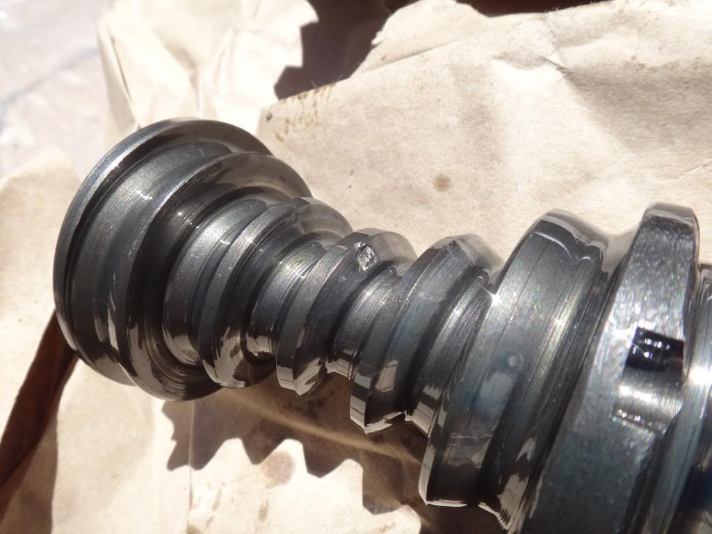

Now the steering shaft can be withdrawn. I found my problem in an otherwise pristine looking worm:
