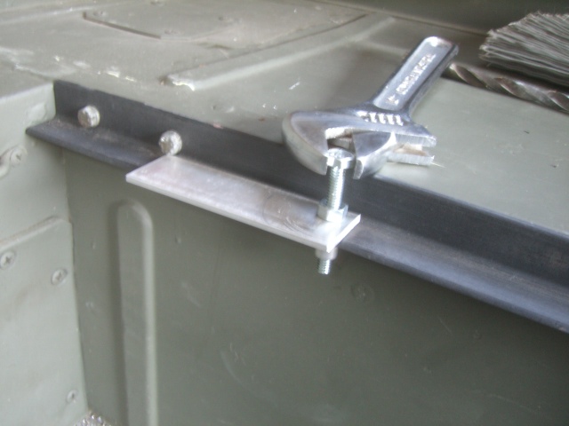

I made my own.
Re: Nutsert Tool
I did the making of my own tool when I had just 1 rivet (on the safety cage)
and it was the only thing I had to do. When I removed the rails, 4 or 5 of
them were rusted/frozen to the point where the bolt broke off, so I had to drill
the rivet out. Doing it with just a couple nuts and a bolt was a PIA. (My
wrenches were too fat) So I just ordered that wedge shaped tool, since it
was only $20 and I have only 4 or 5 to do. If I had 20, I'd by the fancy long
handled tool.
