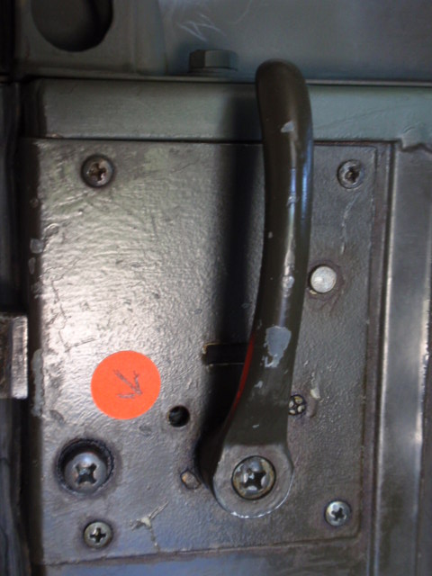

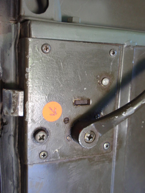

In the photos the orange sticker has an arrow pointing to the latch blocking screw.

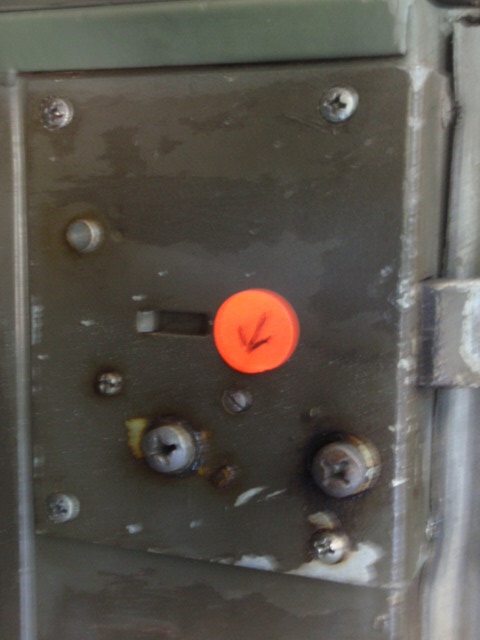

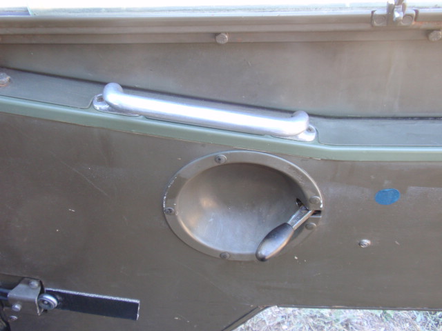

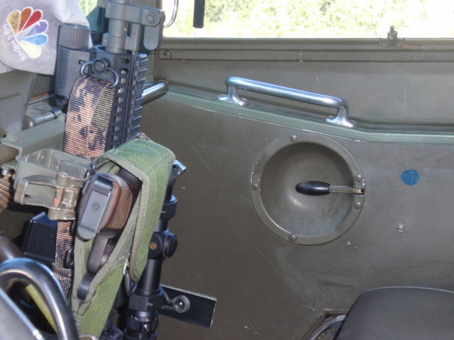

Well there is a solution for that. If you remove the front door panels you will find that the rod that connects from the door handle to the door latch mechanism is actually two pieces (at least mine is) and is held together in the middle by a couple of screws. If you remove these screws you have a choice of assembling the rod as a short rod or a long rod. It is normally assembled as a short rod. If assembled as a long rod the door handle will stand out from the door when the door is closed.
Examining the plate near the latch plate you should observe a small screw as in the photo. If you remove this screw and have the rod in its extended position you will now be able to press the door handle back to the position (flush position) your used to, in this position the door is locked from the inside and can not be opened from the outside key lock or no key lock.
Now for the bad part, it the door handle is in the flush position while closing the door the door will be locked to the out side and must be opened from the inside, this is why I never altered the drivers door in this manner. If you change both front doors be aware you may need a long coat hanger or be able to reach in an open window.

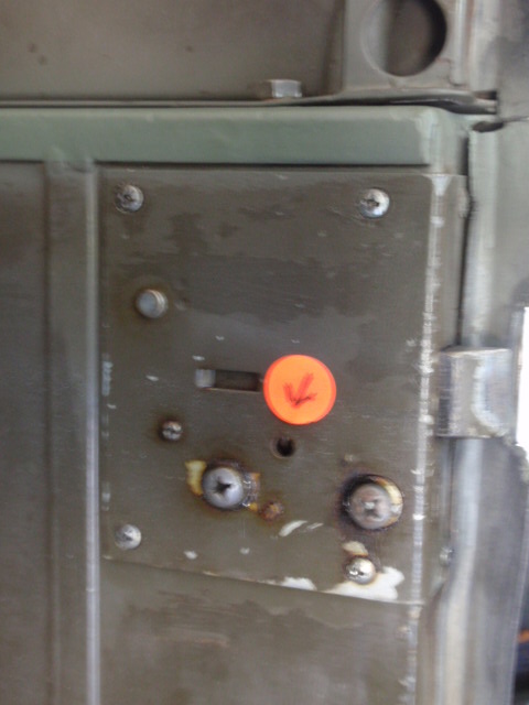

Now onto the rear doors on the 710K, for camping or overnight at a rest stop I sleep more securely with the doors locked. When I first got my Pinz I simply slid the window open, reached outside with the key and locked the door. Problem was now I was locked in the back of a tin box with no easy escape.
So on to the solution, remove the same screw as in the fount door latch and you now have a door handle that has a locked position. See that screws only purpose is to prevent the door from being locked from the inside. Now the only problem is if locked from the inside the key will not unlock it from the outside, and if the door handle is in the locked position when the door is shut the door will be locked to the outside requiring you to accesses it by going thru another door or with the previously mentioned long coat hanger.

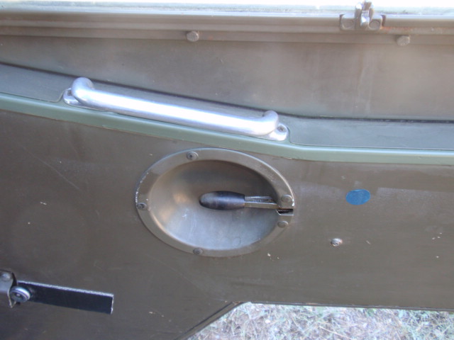

Unlocked
Unlocked
1 front openable from outside.JPG (69.59 KiB) Viewed 10081 times
Locked
Locked
3front unopenable from outside.JPG (69.57 KiB) Viewed 10081 times

The screw not removed
5front lock blocked.JPG (83.47 KiB) Viewed 10081 times

Screw removed
Screw removed
6front unblocked.JPG (83.75 KiB) Viewed 10080 times

Rear door 710K screw removed and handle in locked position
8Rear locked.JPG (89.53 KiB) Viewed 10080 times
