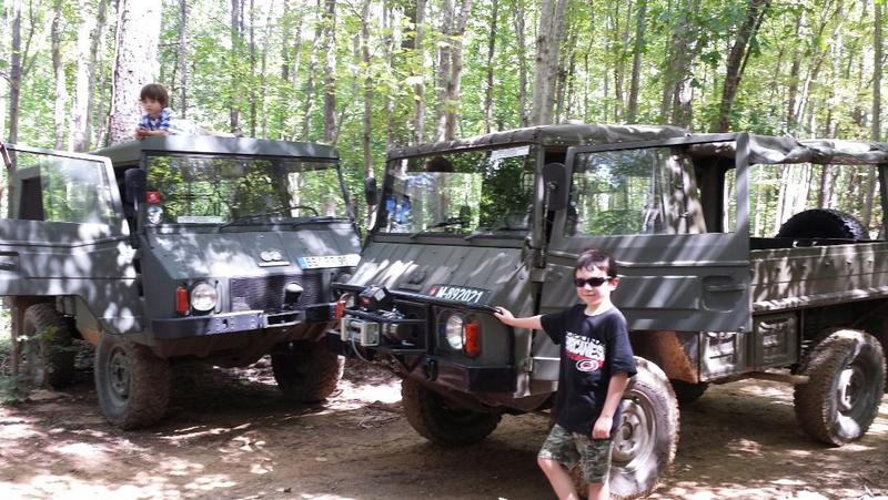

Obligatory picture attached. Mine is the one with Andre's bumper and winch.
