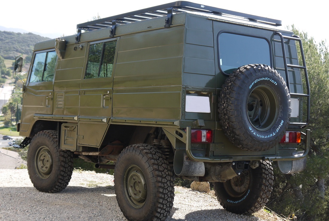

Re: looking for gutter rail roof brackets
Vince picked up this nice set up in So Ca. and it worked out great. I made the ladder.
Hey Andre,
I definitely want your ladder.
I'll let you know when I talk to you for my bumper build. pm me a price on the ladder!!!!
I think a redesign on the black rack for me will be the perfect set up. I have a CVT RTT and CVT Awining to mount. Plus I really love the look of it. It'll definitely fit the look I'm gunning for!
Here's the link for that roof rack supplier-
http://www.frontrunneroutfitters.com/ca ... ch_results
-and the ladder runs $250.
Front runner racks are very pricey
May as well have Andre build you a stronger custom one if he is going to be building a bumper and ladder for you!
The Front Runner racks are extremely pricey, but are very adaptive with the "T" slots that allows for tiedowns to be moved without drilling holes.
That rack is what Vince used on the 710K above. I have one on my JKU and will fit one to GG in the future.
I'm against drilling holes into the roof. My 716 had a rack similar to the blue one when I had gotten it. There was cancer spending from every hole.
If you're fabricating your our rack, making the mounts are not that difficult, and the FR's are a nice simple design to copy.
