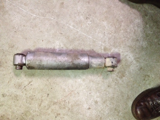

Just finished installing new Doetsch Shocks from EI on my 710K.
Of note, and wondering if anyone else has had seen the following problem...

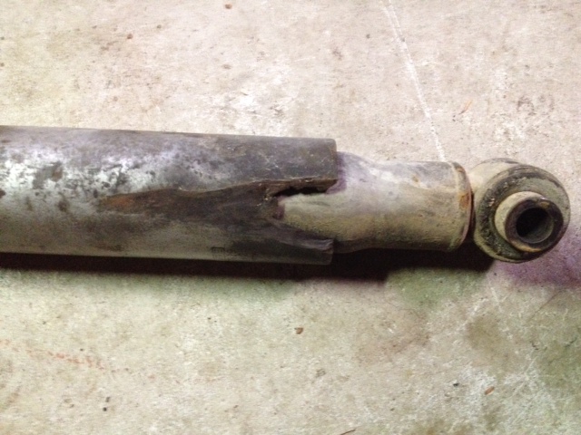

The old shock removed from the front passenger side had so little clearance
between the outer upper metal sleeve of the shock and the spring that it was
worn though in bottom area facing the coil spring due to friction. Hmmm, I
thought I heard some rubbing at Mogfest :?

Yup! Looks like It's the Wheel drive housing, should be rotated an additional ~5 degrees counter-clockwise.
That would move the bottom of the spring to the left and shock to the right. See PIX showing the shock
where the steel sleeve took a "set" in the rubber bushing in a slightly up direction -- indicating a mis-alignment.
Suggests this has been this way for a long time to set in the rubber like this permanently. This rig (Mozo), did
have a body off and re-build around 1999 to 2000, someone may have put this together this way and didn't
notice :roll:
