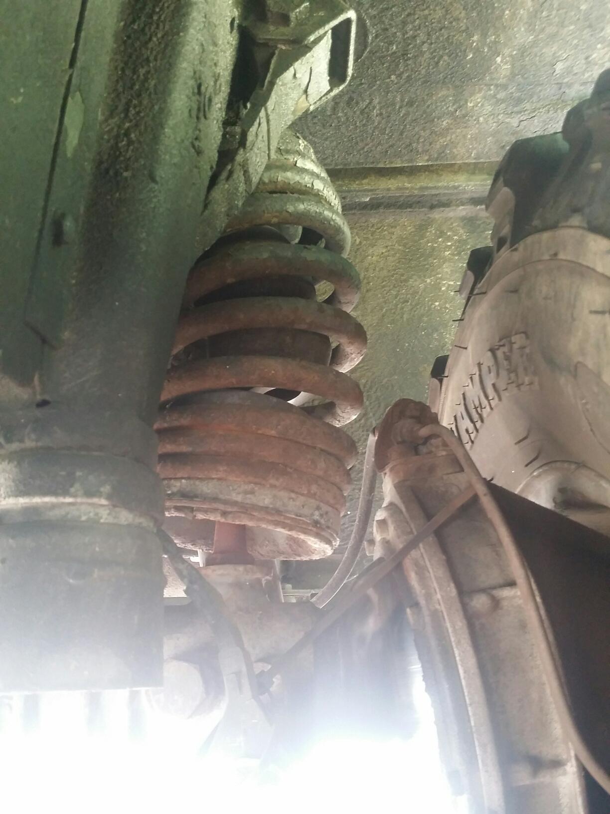

Noticed a lean to the right side today. Looked underneath at the spring and noticed it is a tad "off plumb". What is causing this and how can I fix it? Thanks for the help.

Re: Broken Front Spring Cup
Looks like the pin isn't properly seated into the cup. Needs to be compressed and special attention placed on centering the cup onc the pin. There is a little edge on the center of the cup that will catch the pin if not done properly

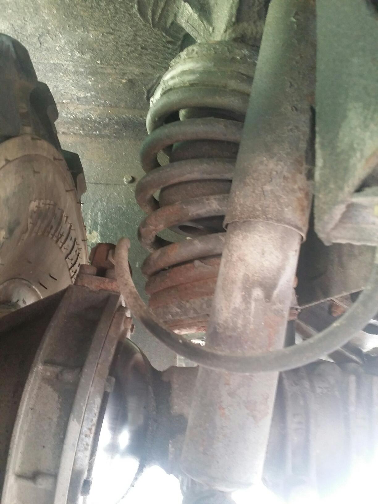

Thanks Audio. What would have caused this? Do I/should I replace something? I've attached another pic looking at it from the front.
tough to tell. is the cup rotted or is it just off of the pin? Feel up in there... is it smooth, or rotted through?
You'll need to compress the spring to place it back on center. You may be able to come up with an innovative method if youre handy. Im cautious not to tell you too much as those springs are really dangerous and you could hurt yourself if not careful. Post some ideas. ill tell you if youre on the right track - or take it to a shop.

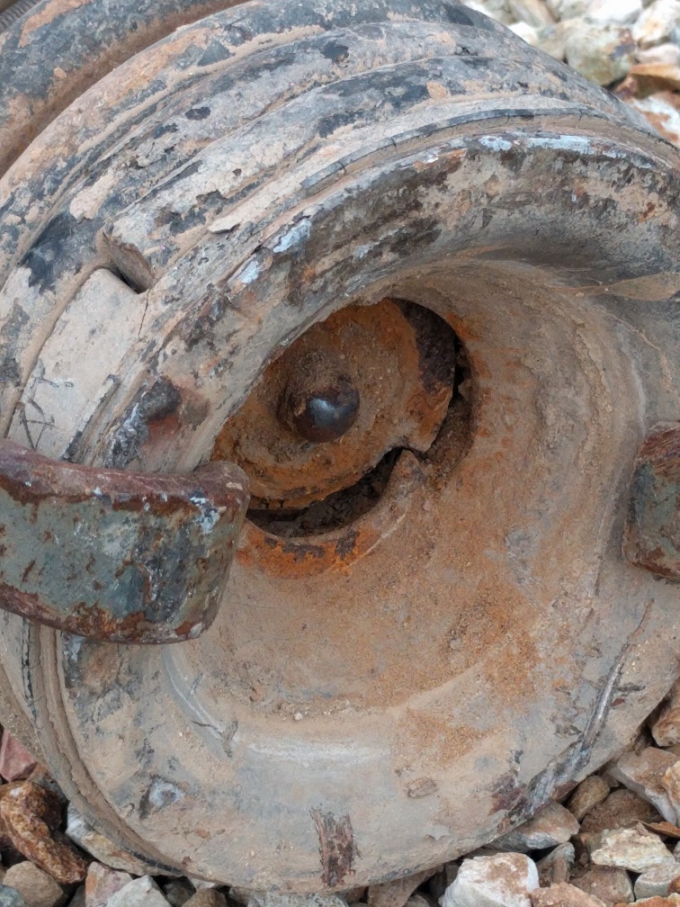

Just replaced my forward right cup. Noticed the front right sat a little low.
Grabbed the community (Southwest Pinzgauer Association) spring compressor tool and removed the spring.
The cup had rust/busted thru and the frame was sitting on the cup. I managed to fully extent the axle/spring after I remove the strap and shock and managed to pry enough to get the compressor tool to fit in. After that it was cake. Jacked the wheel hub until the rubber stops hit and tightened the compression tool threads.
The spring assembly came right out. It was a little scary handling that compressed spring to the shop to get the tool out and then to set it back in once I got the new cup. I also noticed once I took out the broken cup that the cap cup had been deformed by the broken chunk that was still riding on the cap cup. Formed that back flat and it all went to together very easy.
Now she sits level.
Now she sits level.

great photos. note the rotted cup and the tools needed to replace. Do not try to mcGyver

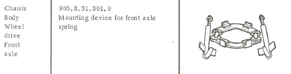

FWIW, I believe the spring compressor shown is a McGyver.
The factory tool had a two-piece flat end that the arms pull on, if I'm not mistaken. PC, can you confirm?
A McGyver is okay, provided it's stout enough for the job.
In the repair manual it shows something similar but not quite the same so could be a copy someone made?undysworld wrote:FWIW, I believe the spring compressor shown is a McGyver.
